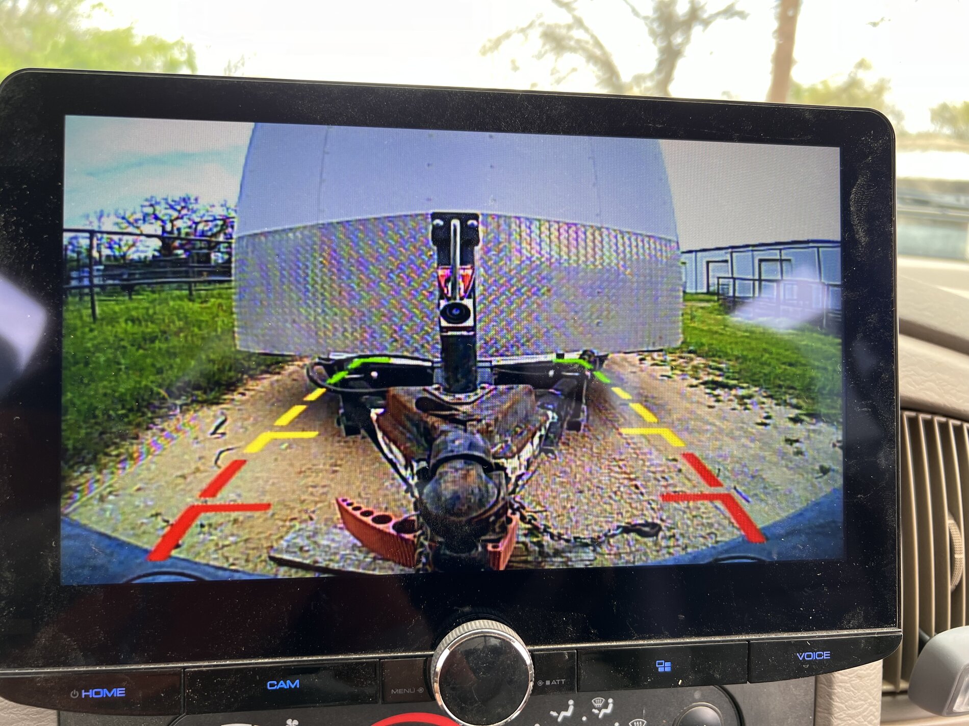

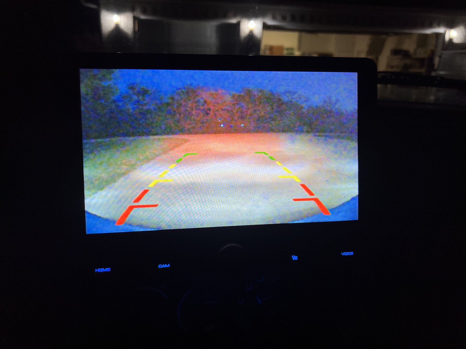

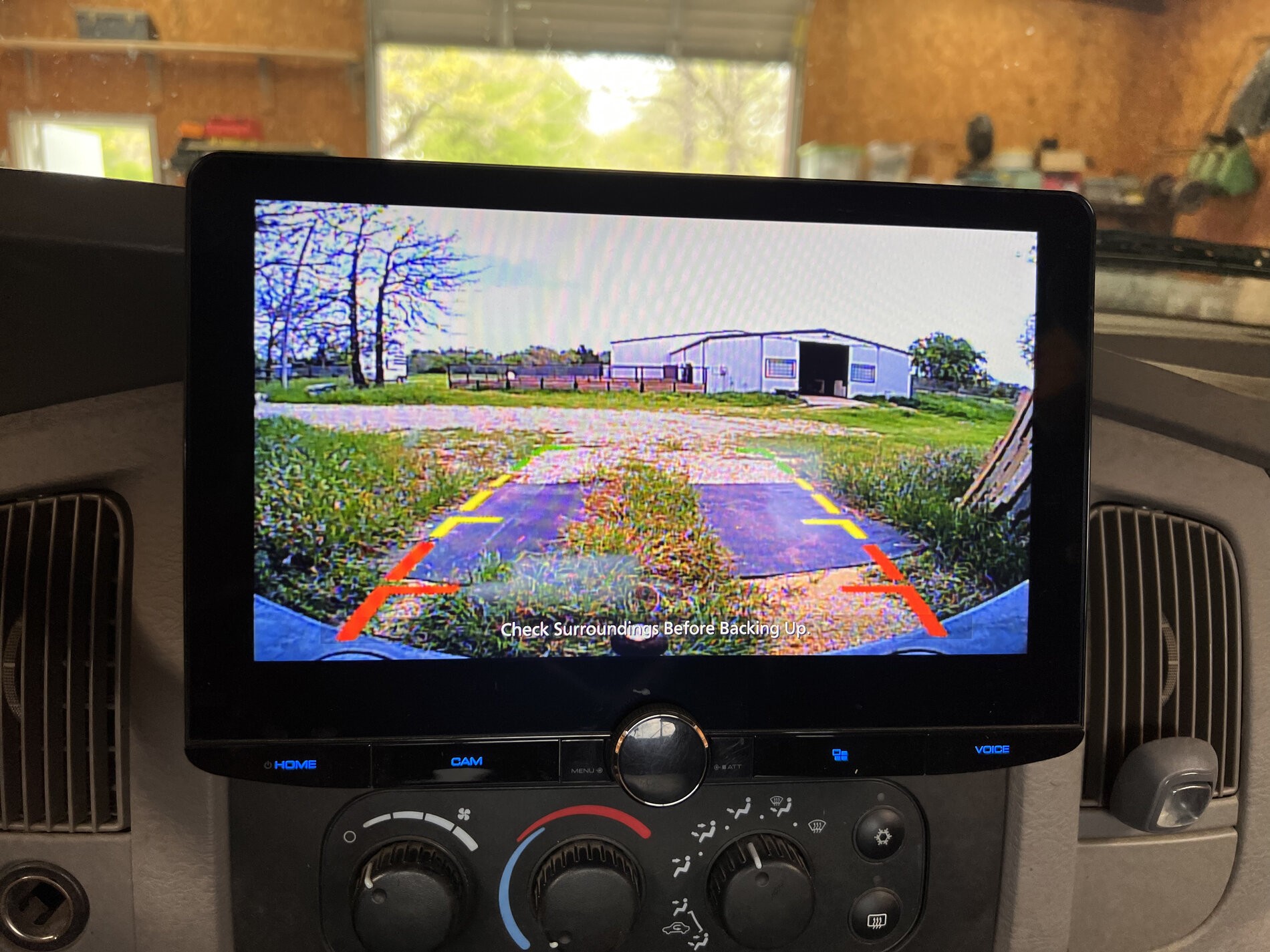

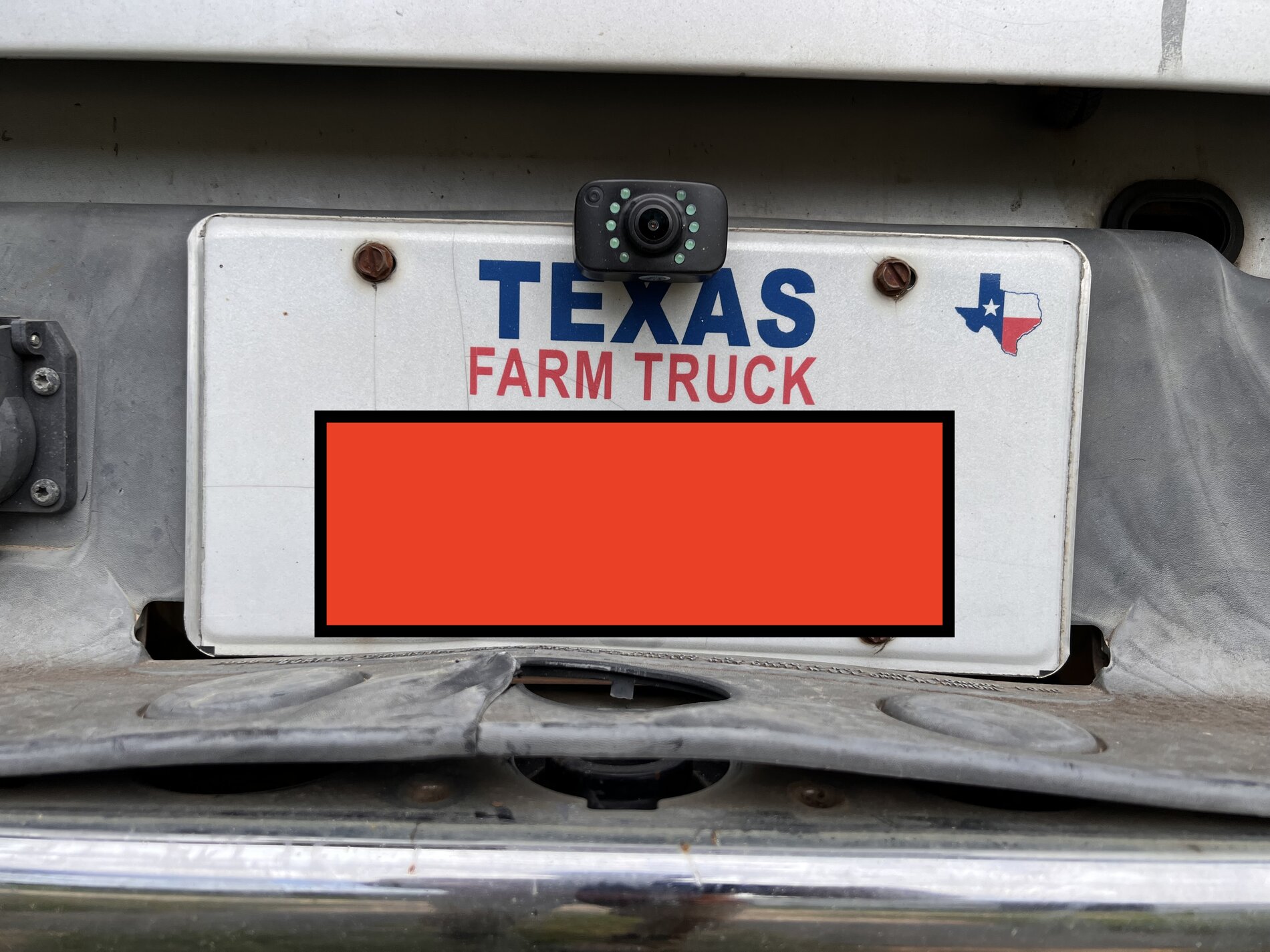

After its all installed I'll post some short videos of day and night operation. camera is 720p and so is my head unit
Here are some pics of the erapta
