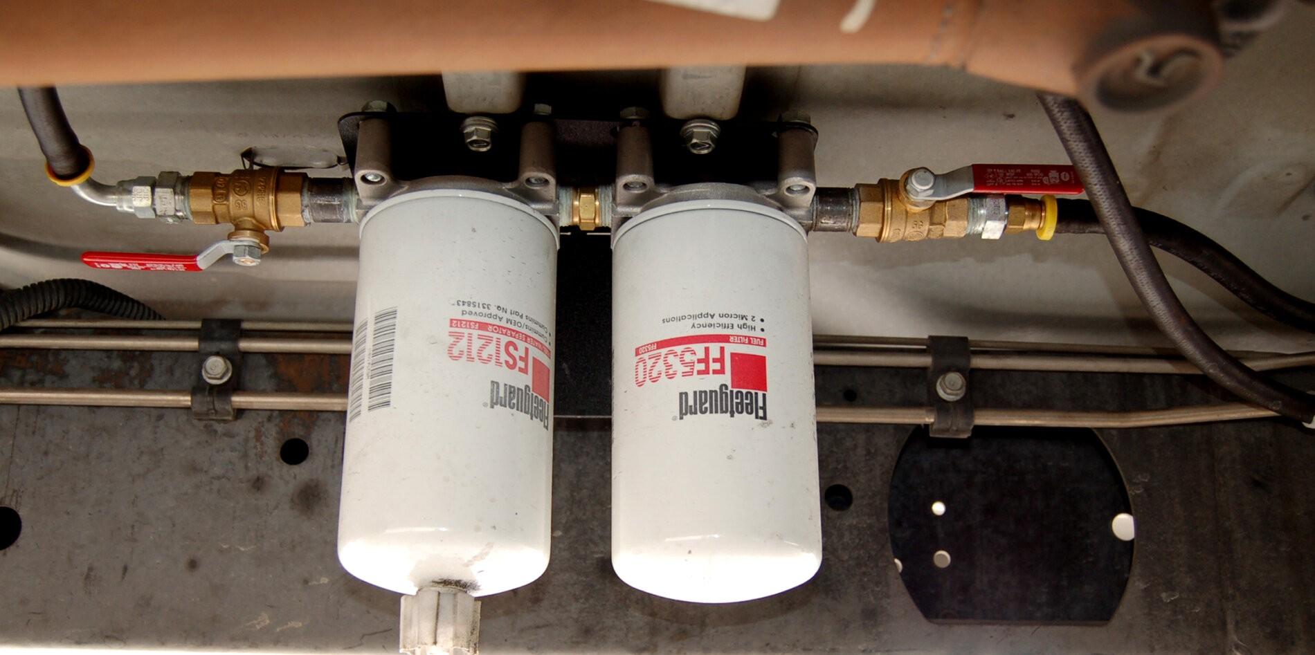

I've had this for years. Purchased from Glacier Diesel Products.
I have the same Glacier setup as JoeMC and is a lot easier for service. I mounted mine on the drivers side frame rail just forward of the fuel tank with frame mounted pump. If you go with this setup I suggest you valve both sides of the filter body to prevent drain down when changing filters.
This is a pic’ of the first install which I later changed from bed cross member attachment to the frame and added the lift pump.

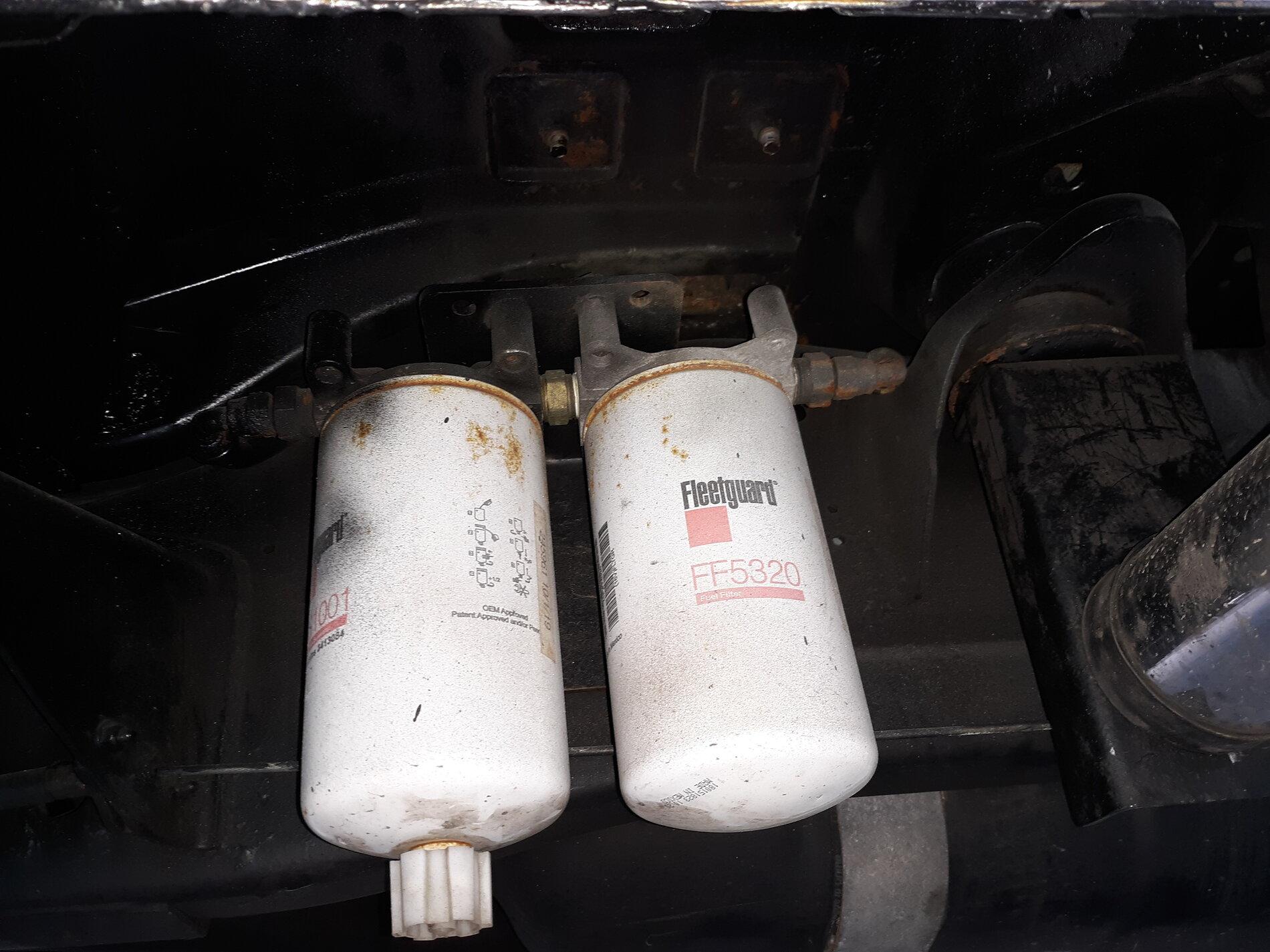

Thanks for pic and reply. Where exactly did you install? Can’t really tell from pic. Thanks again
Sorry for late reply. I installed mine on the outside of the drivers frame rail. As a reference (sorry picture was so dark I did have the flash on too) to the right and just below the FF5320 filter you'll see the tank strap (silver).
