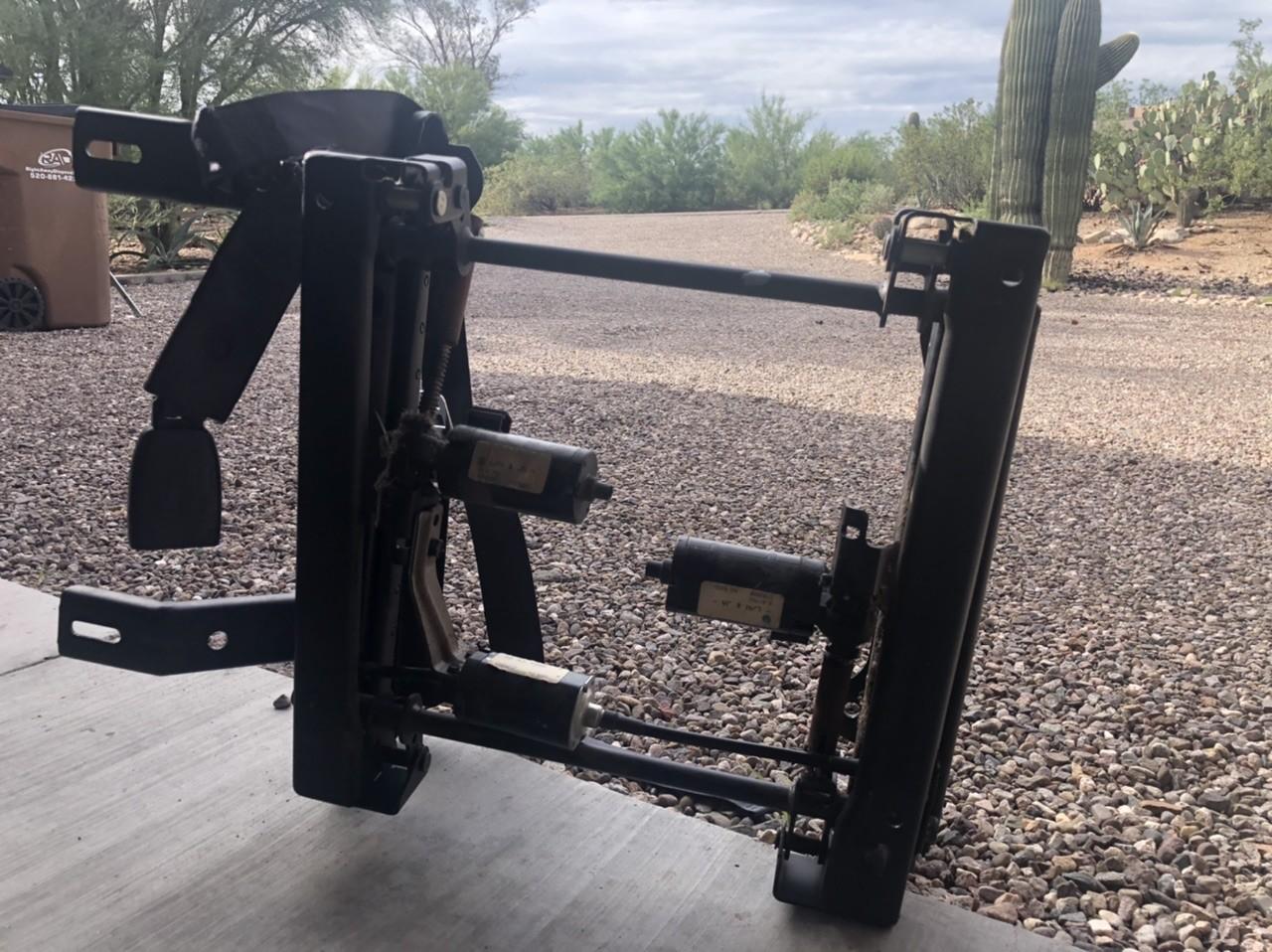

The pictured brackets on the left side of the drivers seat pedestal hold up that side of the center console. The passengers side I believe has the same brackets. They are riveted onto the pedestals.
Yes my memory is same as the third gen jump seat... just pull the 4 bolts and it comes out, there will be the extension brackets from the seat frames remaining tho.
