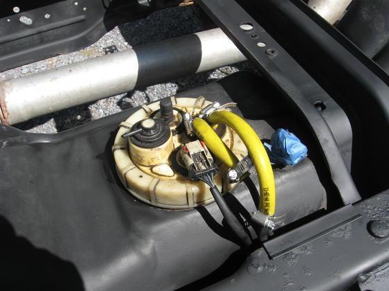

As the title suggests, I removed the bed today to access the top of the fuel tank. A couple of months ago when I changed the shocks I noticed the fuel tank had moisture on the bottom of it but said screw it and put it on the back burner. Well the pot started boiling today when I smelled diesel real bad when getting back in the truck after letting it idle at a store, so went home and backed in the shop and started to remove the bed to better access the top of the fuel tank. After doing searches on here, it seems a common problem that the large nut that holds the fuel module gets loose, I could take mine off by hand, but the gaskets seemed fine. Its a greasy and nasty mess, Im gonna clean it up nice friday evening or sat morning. My question is, while I have the bed off, what else do I need to looks for? Im gonna tighten the nut up as best I can and run that sucker around before I put the bed back on to make sure I fixed the leak. Also, I saw a lot of posts where guys put in draw straws, what is this and do I need one? Truck has 198k and change and has went through the carter lift pumps and now has been running a ddrp on the rail for past several yrs with zero problem and no draw straw. I am also going to swap out the fuel tank straps, the front one is very rusty, scared it may rust thru. And clean the frame up while im at it. Wont be able to respond til fri evening, sat morning, out of town again as of tonight. thanks in advance.

Thanks for the replies. Found the leak on the return fuel line at the metal 90. where the hard plastic line met the metal line was all corroded. I put stiffeners in both plastic lines and just clamped a rubber hose to the existing metal 90's. stopped the leak. Also had my fuel module out and it was in perfect shape, no junk in the tank that i saw or in the screen, looked like brand new. Truck runs fine and fuel pressure stays normal. I also am working on taking rust off the frame while im at, makes me feel better. Ordered a rear fuel strap from dodge, and 8 new bed (box) bolts. Still debating whether or not I should stop being a cheapskate and get the draw straw to eliminate the metal 90's. I cut the clip style connectors off the plastic fuel lines, does that matter for the draw straw to work?

Finally got everything buttoned up today. I put in the draw straw and am sure glad I did. I deleted all the metal fuel lines. Feel better that I dont have the half a$% setup I have pictured. I also changed out my rear brake lines, thanks for advice. Got the bed back on with no issues, hope i never have to do that again, alone anyways. Also seems like my fuel pressure increased a little bit, and I even installed a fleetguard inline filter before the lift pump that I have never had before. Not sure if its just because I havent driven the truck in a few wks and am so used to driving the gutless ford and chevy gassers at work, but it seems to have a little more throttle response, probably just imagining things, all in all, pleased with how everything turned out.

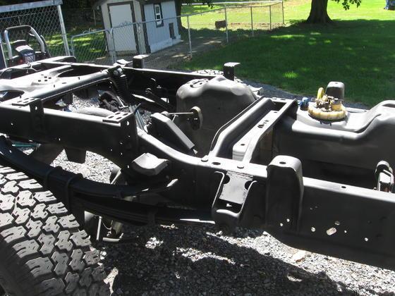

8 Bolts total, 4 in the rear (2 per side) in the spare tire area. 2 amidships (you can see the mounts in the picture above) and 2 in the very front of the body.
Unplug tail light harness at rear junction. Remove torx screws that hold the fuel filler neck to the body. Assuming that he does not have a fifth wheel hitch that should be all that is involved.
