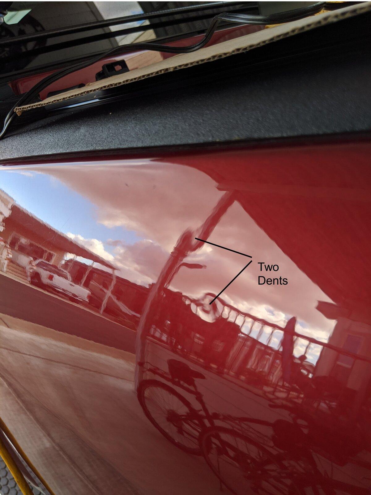

I have a couple dents in the side of my bed. Looking at youtube I came across a dent removal process, so I ordered this kit from Amazon.
The other day I got the larger one down to the size of the smaller one before running out of hot glue. Amazon will deliver more glue today and I will be back at it.
This is before I started.

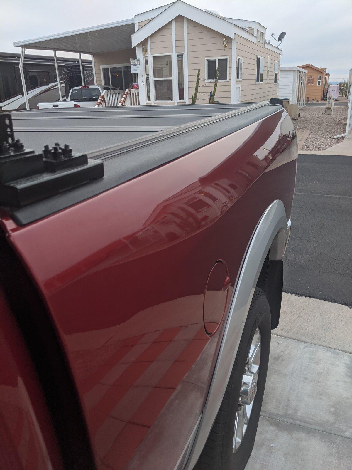

I spent another 1.5 hours working on two main and one slight dent. It was cold out again today. I would stay that I removed about 90 percent of the dents. You have to now look for them to find them. I will work a little more one them when it is warmer and I can let the sun shine on the panels warming them. It is a slow process, but I am retired, so time on such a project does not mean much. SnoKing

Actually looks pretty good in that pic, better then the headlight bulb swap/headlamp swap pictures of before and after, those all are not for me they all look pretty bad the before and afters.
Some fixes just have to go by the recommendation, but sounds like this works.
Your pic looks good of your repair.
