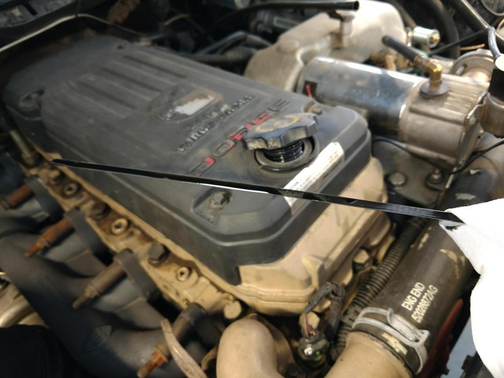

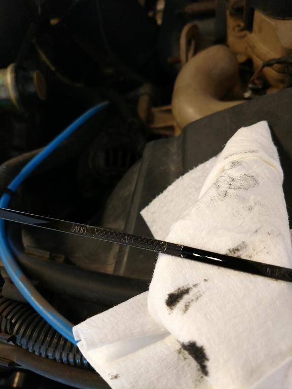

Pulled stick out of engine 3 times and get this reading after sitting 3 hours.
Remove oil fill cap and a bunch of oil drops on the dipstick.
I would run a quart of MMO in the engine a 1000 miles before next change and see if that changes anything. Whenever I see weird reading son the dip stick, it is time to clean up the oiling system.
It shouldn't be a vacuum issue, note that once you pull out the dipstick, you have "unsealed" any possible vacuum if there were any to begin with. It is very unlikely that there would EVER be any vacuum in these engines since they are vented to the atmosphere through the valve cover breather (and the dipstick tube once it is pulled past the o-ring). This is very strange indeed.
