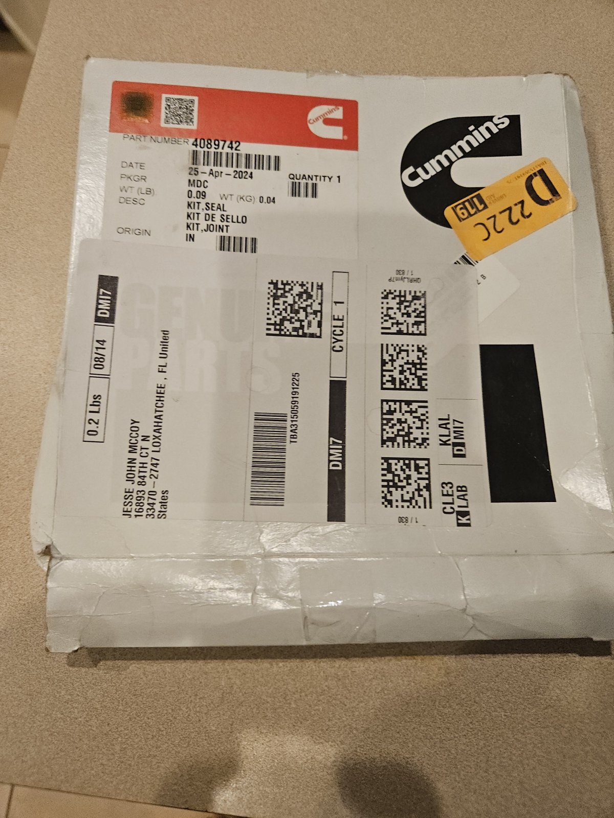

DON'T buy the "Genuine Cummins" seals sold on Amazon! They are fake crap. They fit like crap ans leaked everywhere. Purchase the one from Geno's Garage, which I had also done years ago, and it worked.
My experience working with Geno's since mid 2001 is they vet what they consider offering before selling, provide great customer service and have no problem shipping out replacement items if damaged shipping. Highly recommended
