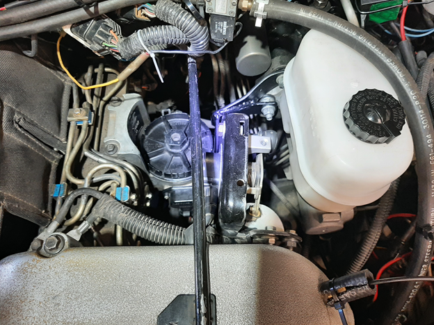

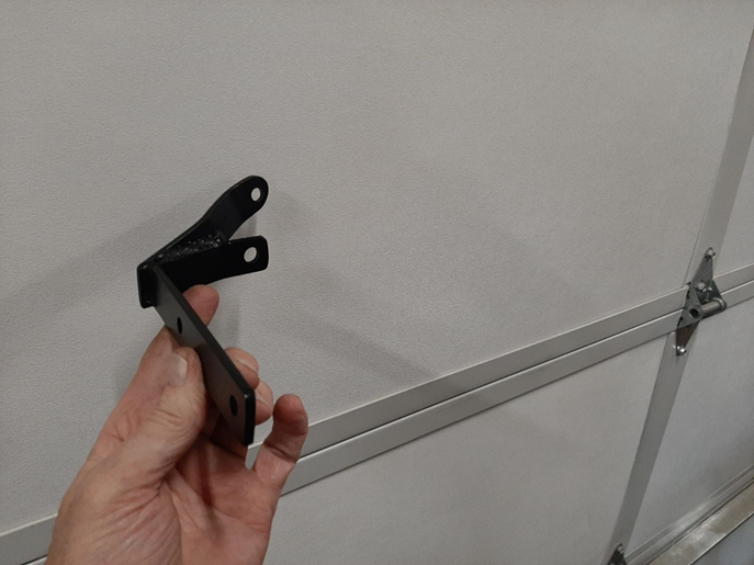

There are no changes inside the cab. I just relocated the complete APPS throttle assembly to a place between the brake master cylinder and the oil dipstick tube. I fabricated a custom mounting bracket and used two existing bolts on the hydraboost / brake master cylinder unit for mounting the bracket.
This photo shows the custom fabricated mount and its new location.

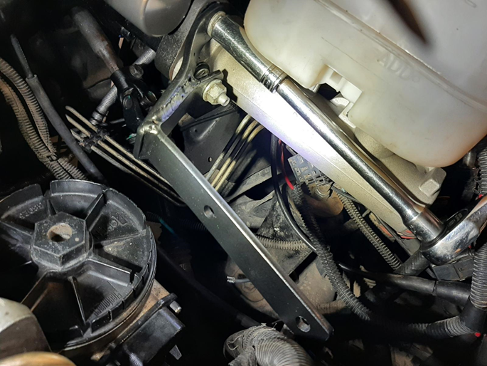

Two more bolts and nuts and the throttle assembly is mounted.

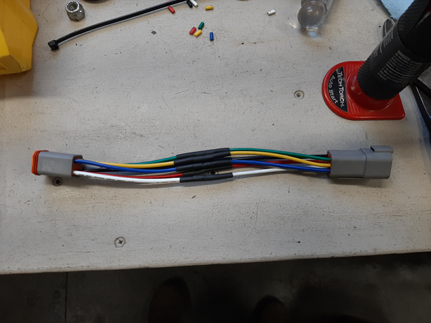

With the use of Deutsch female and male two-pin connector harnesses, I lengthened the wiring to connect the ECM to the APPS.

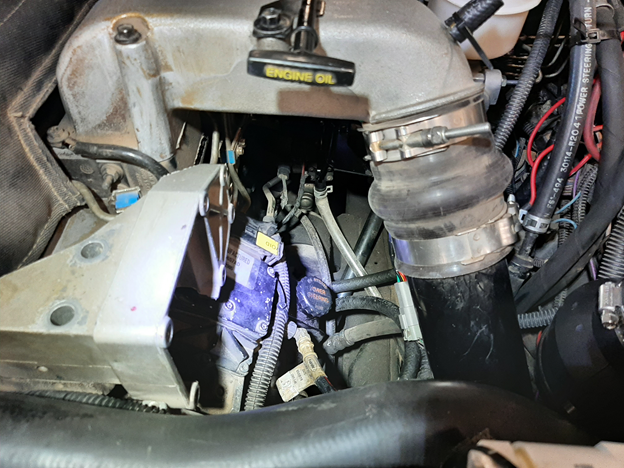

Here is how much space that has opened up with the removal of the APPS assembly. The big aluminum mount on the left wasn’t yet removed when I took the photo.
