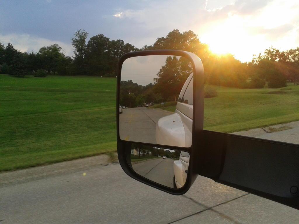

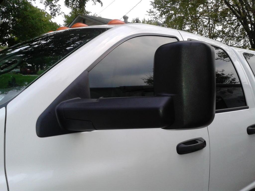

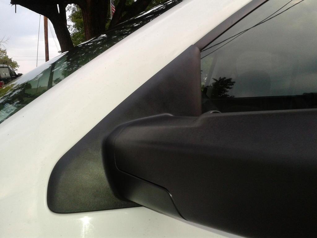

Well I ordered a pair of the 4th gen style mirrors from 1A Auto and really like them. I like the larger convex mirror and being able to see a wider area on both sides. We went camping this weekend and it made it much easier to back in from the right side. There is hardly any vibration at 70 mph. I didn't realize how much the old mirrors did vibrate until I installed these. The main part of the mirror is all that moves from the power controls, the convex part is adjusted by hand.
I did have to return the first set I received because the passenger side would only adjust side to side and not up and down, I called 1A the next morning and had two new mirrors the next day! They emailed a UPS prepaid return label to return the first set. Very happy.
Here are some pictures:
