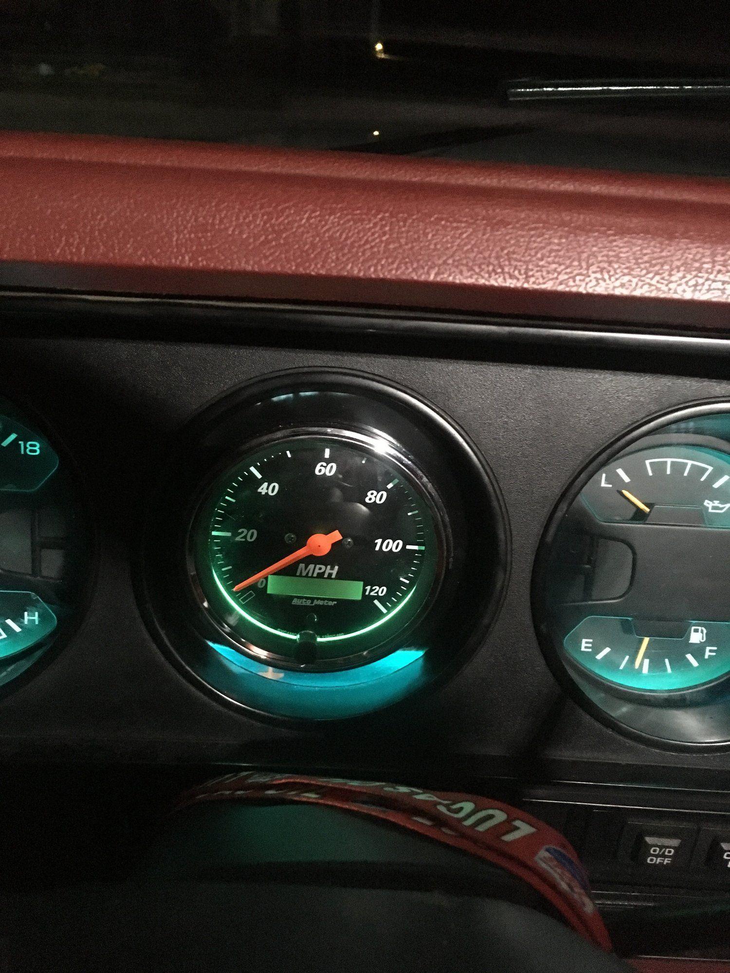

Here is how the new speedometer turned out. Cut a hole in the dash cluster cover and then painted it black in the middle.
