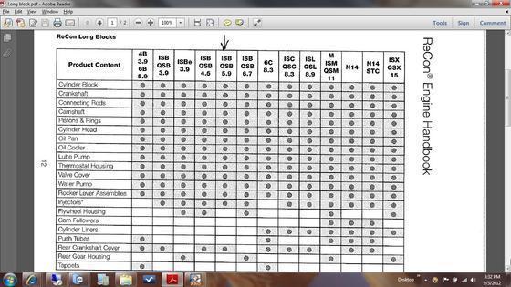

Check Cummins??? Call your local Cummins dealer or distributor and provide ESN or VIN so that they can identify the CPL of the engine. Get a quote, may not be too bad.
Long Block Contents by Model...

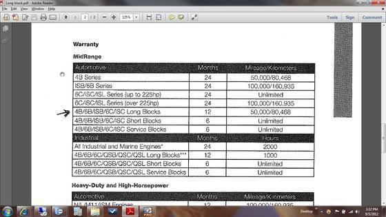

Long Block Warranty for On Highway Use.

Depends also on how good a result your dealership wants for a finished ready to sell truck...

And there is a very good chance using the matrix I posted above that the Cummins long block offering will have injectors with it.
The asterisk indicates that some do indeed come with them. Need a serial number and CPL to know for sure.
Something to consider at least... ...
