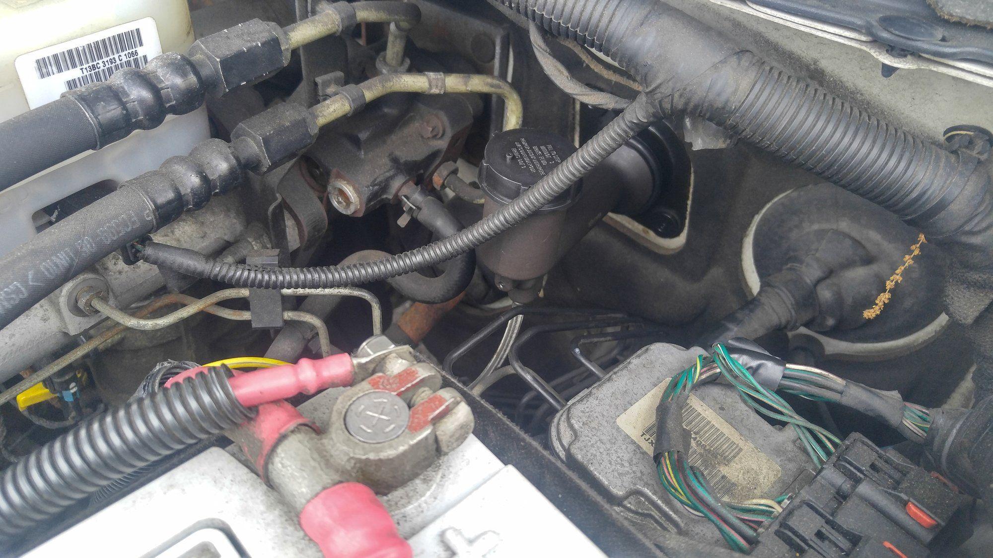

Can't do any better than video with regards to photos, but I uploaded one. Don't know about the new unit, but the factory unit or at least the reservoir from factory unit had "Made in France" stamped on the side. The old unit was leaking at master to the point the springs inside clutch pedal position switch partially deteriorated. I cleaned out the switch which otherwise seems good and will order identical springs from McMaster-Carr before putting together.

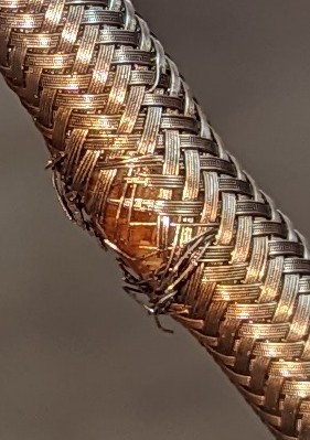

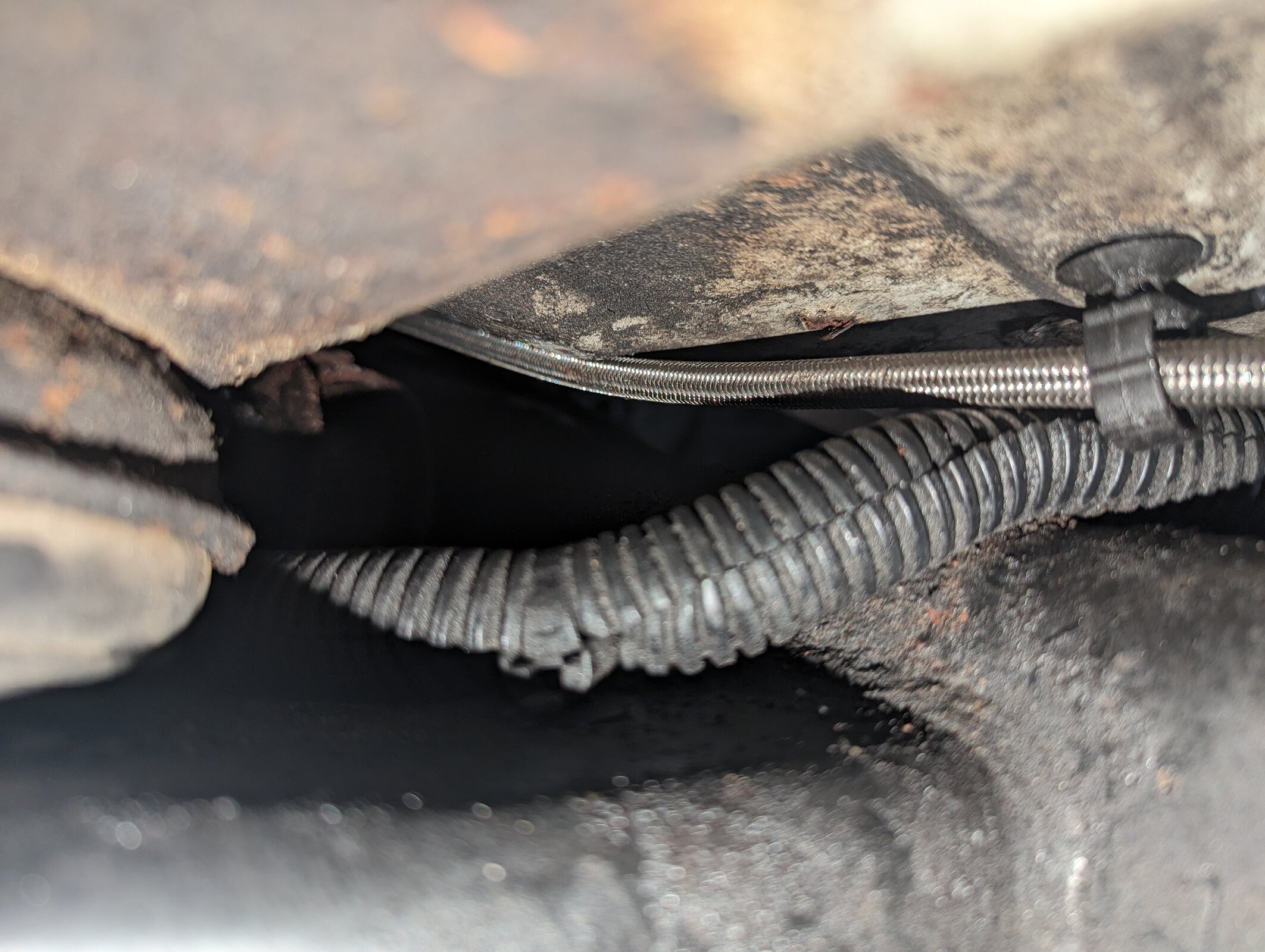

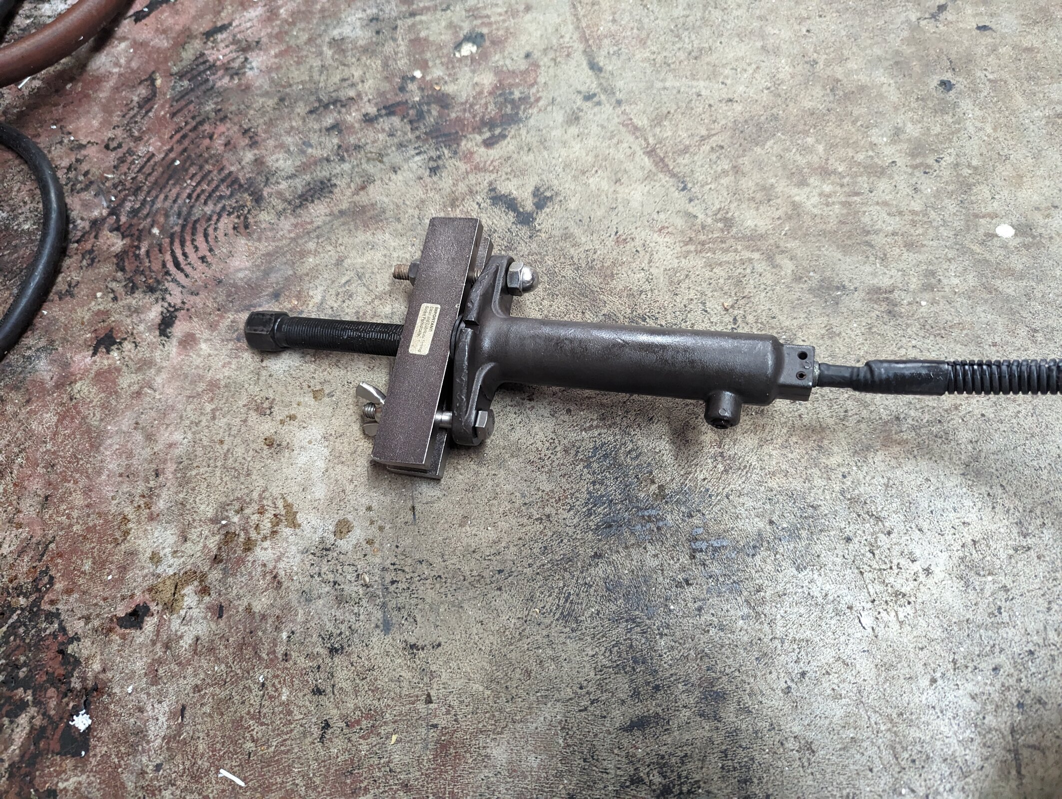

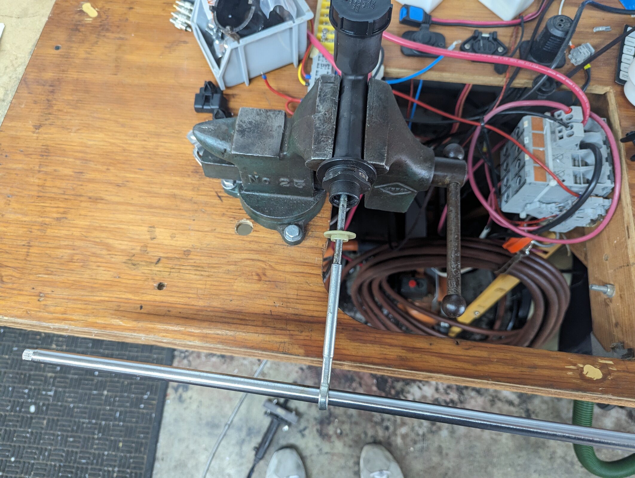

Stainless braid and hose chafed 34" from clutch slave at location where hose transitions from horizontal to angled vertical ( up the firewall ). I've installed some split wire loom at this location ( photo embedded ) on the replacement. Finding was tricky because it only revealed itself when bled so as to be able to generate pressure with the pedal and bleeding a system with a hole doesn't work so well :). After I replaced with identical unit I bench-tested per the Perfection bleed video above which made it much easier to realize what was happening.

I have never been a fan of external steel braided hoses. The very thing that is supposed protect the hose is what ends up damaging the hose. Once the braided wires break, the sharp ends of the braid become the enemy. Sometimes they break just from repeated normal movement, they don't necessarily have to chafe against something.
Probably, one of the reasons my system has lasted for so long is that it is a rigid plastic hose (of course, everybody hates plastic) without steel braiding.
- John
Rubbing like it was, it would have worn through much sooner without the steel braid. It was routed and secured poorly.
