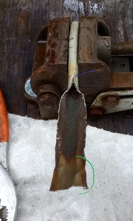

My truck is 22yrs old. While the steel lines look fine, once I replaced them I noticed a 3psi increase!
Here's the inside of my steel fuel line. [The violet line: dremel cutting wheel has been consumed; turns out that was my last one! The green line: finger & dry paper towel rubbed off the buildup - there doesn't appear to be any significant interior rust. [truck lives below the MD line.]]

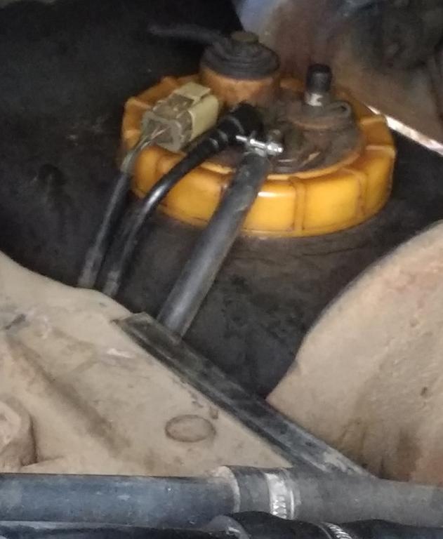

15mm socket. Remove the four D-side bolts holding bed down. Loosen the four P-side bolts. They dropped down about an inch, yet remained securely threaded to the bed. Unplug D-side rear brake/signal lamp. Unscrew the fuel filler neck. Get help - an extra set of hands needed here. Lift bed as high as it can go. Use multiple 2x4's to prop the bed up. Now you have access to the top of the fuel tank! Feed line on the right--towards rear of the truck.

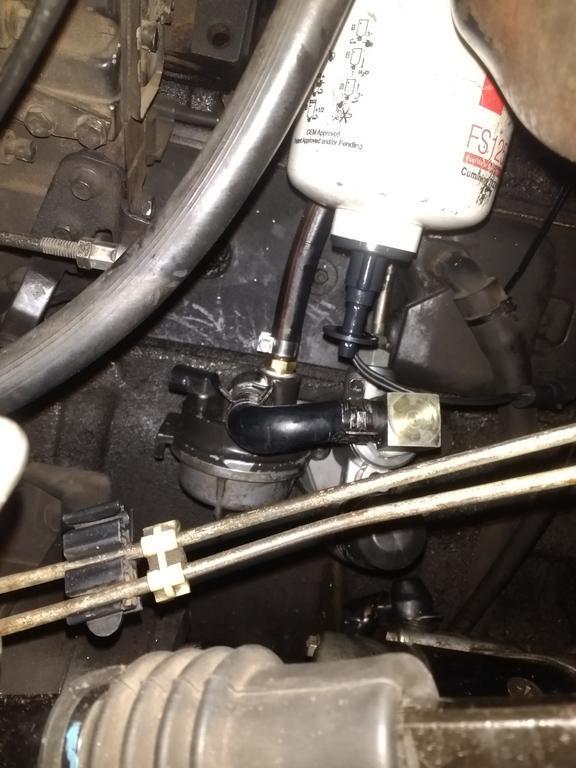

She fires up immediately. [It's winter, & she's not garaged [sadly]]. I went from 24psi to 27psi at idle after installing the new feed line!
Everything up to the IP is new: LP, fuel filter, WIF [yes, I plugged it back in!], that short 90* hose, and the feed line.

Hi RMcKinney 1995 Stock 2500,
I got a NAPA diesel inline filter. I routed the fuel line from the Lift pump through NAPA filter then the Truck filter.
I did not have to worry about the Pre-heater screen so plumbed the fuel heater out all together.
