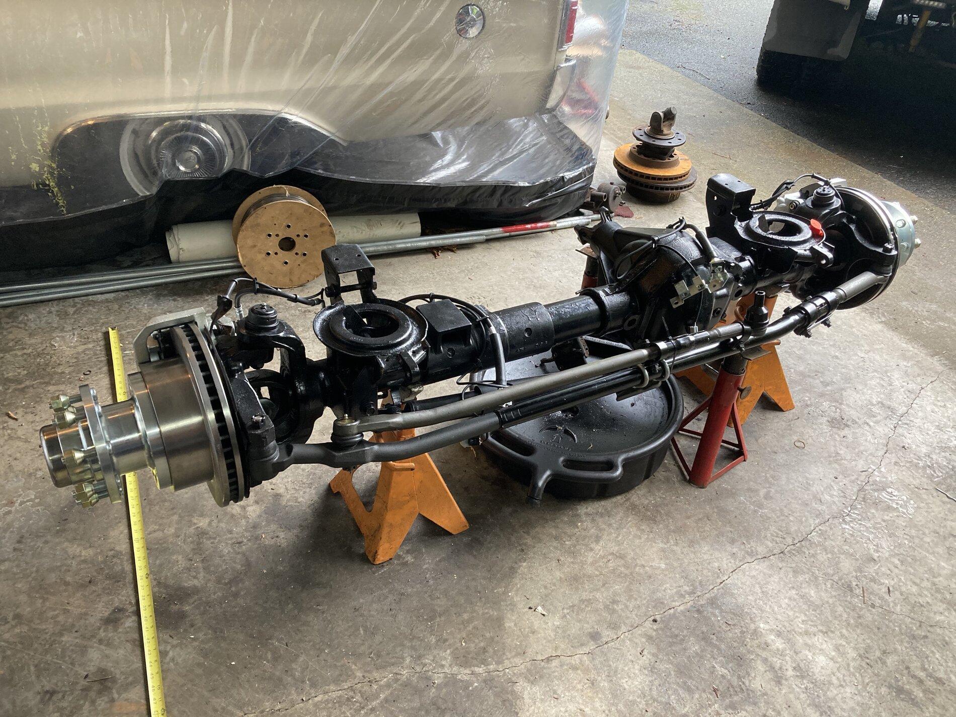

What do you mean "complete steering system"? Two years ago I replaced the vacuum pump and power steering pump and lines. I pulled the steering column out and installed new bearings. Replaced the intermediate steering shaft and used a Red head steering box. I upgraded to a 2002 front axle from my 99 for the two piston brake caliper and larger axle. The front axle I rebuilt with all new seals and bearings from one end to the other and used EMF ball joints. At this time I went with free wheeling hubs also. New calipers, brake lines, rotors and wheel speed sensors. I used third gen steering linkage, and panhard bar. I did this over one winter, about 4 months. I collected all the parts and purchased a axle out of a wrecking yard. I sold my old axle for the same price I paid for the 2002 one. R&R steering column and rebuild was a good 8 hours. R&R steering box and front axle 5 hours. R&R vacuum pump and power steering pump and hoses (while front axle was removed) was about 2 hours. The truck drives and stops great. Would I do this again, YES to a second gen. I guess this is what you are thinking about.
