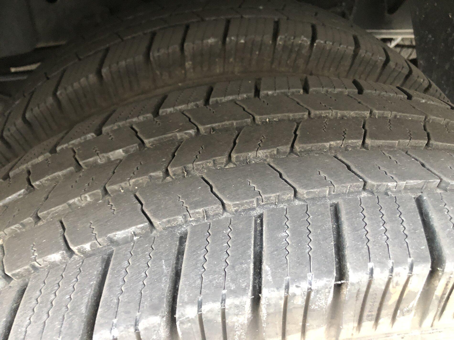

I run 65/35 and this is the result, perfect tread wear at 30k on the tires.
