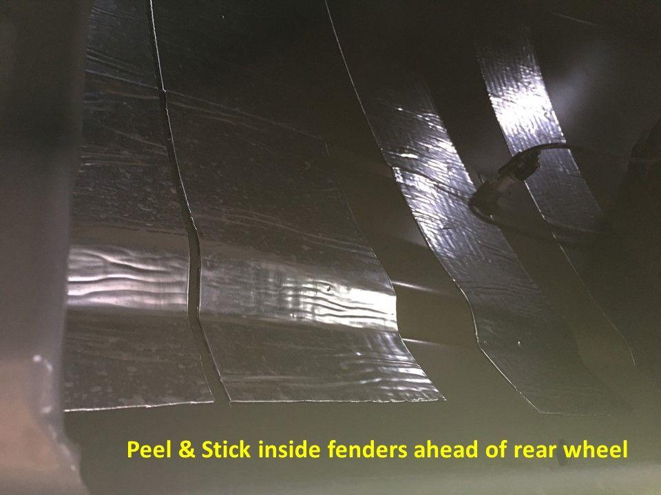

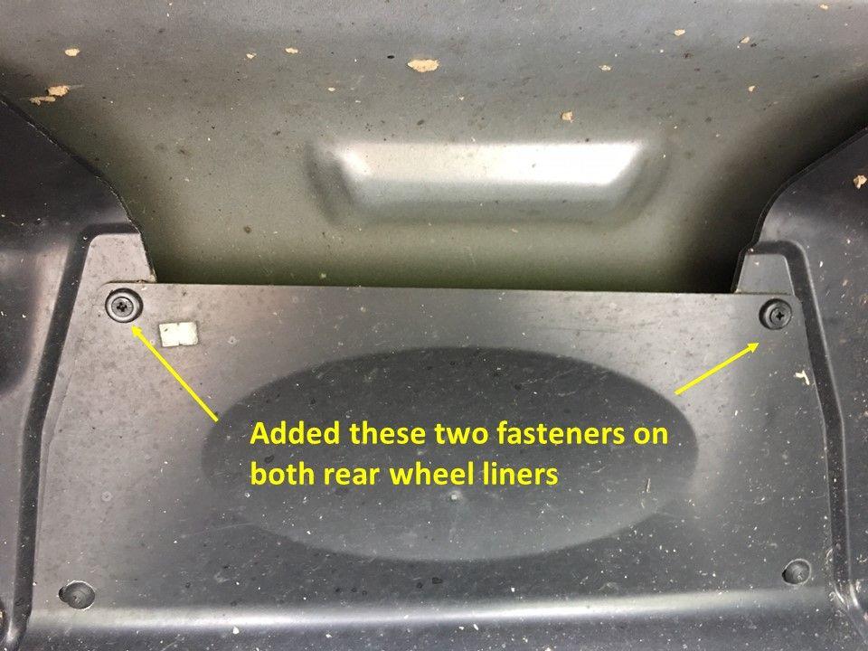

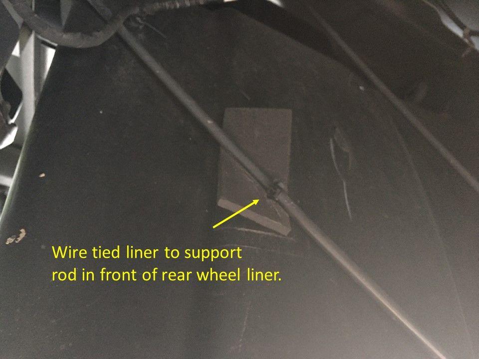

My 2014 3500 Tradesman dually would make an extremely loud and obnoxious resonant vibration during a hard acceleration with the toy hauler in tow. It would only last a few seconds until it passed through the rpm range that excited the vibration. Sorry, I never noted the rpm, transmission gear, or speed, I was usually merging onto the interstate or occupied with the matter at hand. The noise was coming from behind the cab, so I shotguned the problem with very good success. Did three things, not sure if one or all was what did it, but happy with the results.
· Used Peel & Stick from Lowes and lined the inside of the fenders on the bed to dampen the vibration.
· Attached the plastic fender liner to the brace rod with a wire tie, it was flapping loose against the rod.
· Installed two additional fasteners to secure the fender liners on each side. They were loose.
It worked, resonant vibration gone, what a relief.
