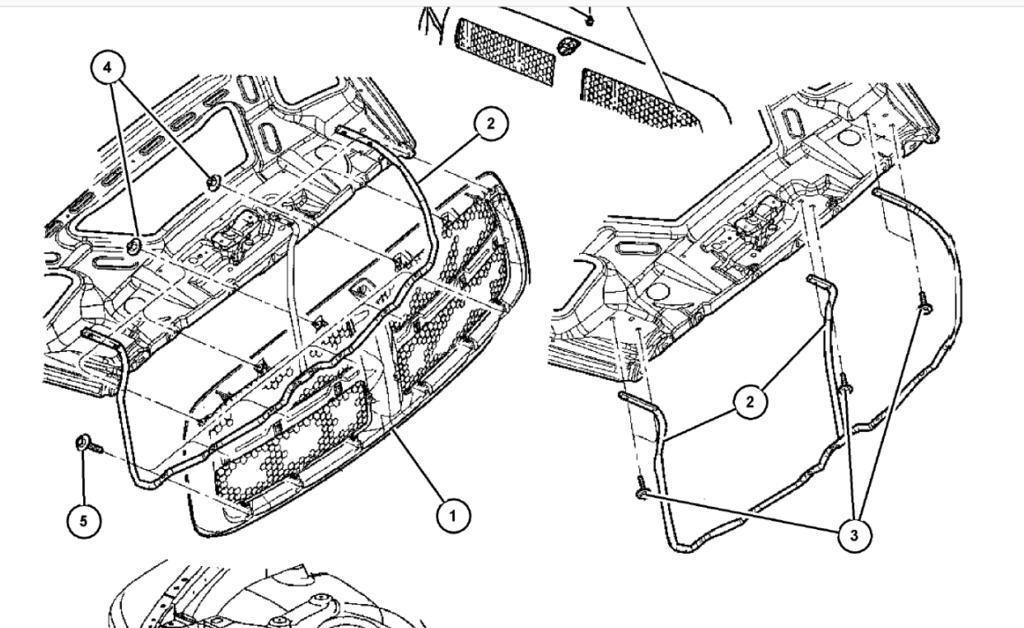

After repainting my 95 and during reassembly, I realized I lost 3 of the 6 retaining nuts for my trucks grille (grille to hood leading edge). Anybody know the number for the nuts? They are a small nut with a built in floating washer. I could make something work but after spending as much time on this thing for a total repaint, I'd rather put factory back on. Thanks

Using my limited skills, a '97 VIN and Repairlink I come up with an M5 X 0.80 Nut and Washer.
Part Number is 6102101AA. They probably have them right there as they are used in a gazillion other applications on the truck...
See if Item # 4 is what you need..
Thats what I needed. They didn't have them in stock either.......they don't believe in having parts on the shelf here in Alaska for some odd reason! I also had them order a window seal for my truck and they acted like a 1995 was beyond ancient. :confused:
