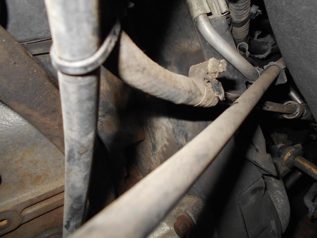

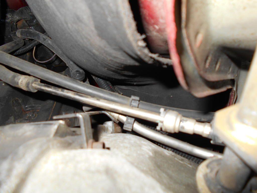

I think I'm just going to replace the fuel lines I got from LARRY B'S, where the old ones are connected. How hard is it to pull the old line off the hard lines?The one line that connects to the hard line on the injector pump, look's to be the hardest.The rest don't look to bad.
Yeah, you'll need to pull the IP to remove the metal line that runs behind it. That's what I was saying, way too much trouble in my opinion for a simple return line. You could probably remove the filter assembly to give you better access to the line in your pic.

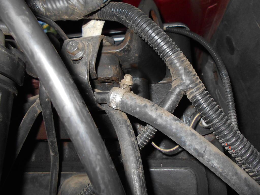

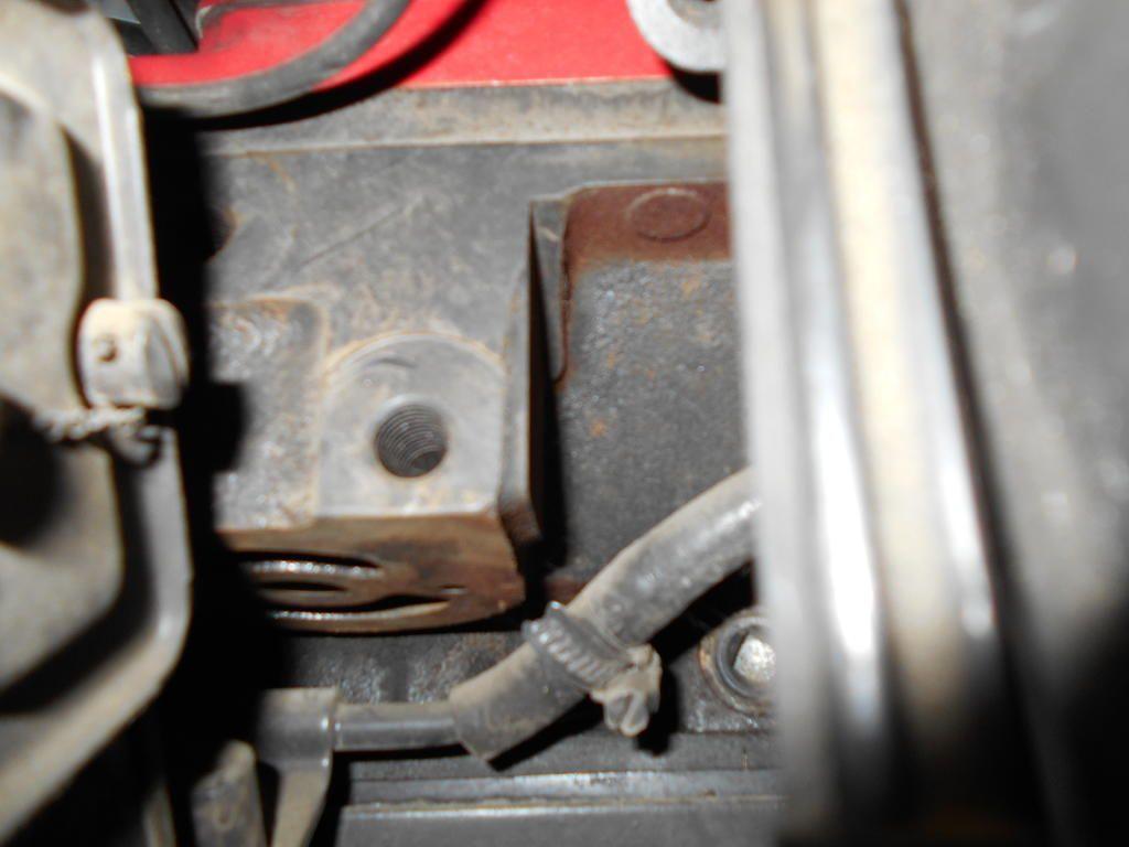

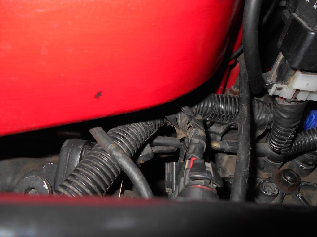

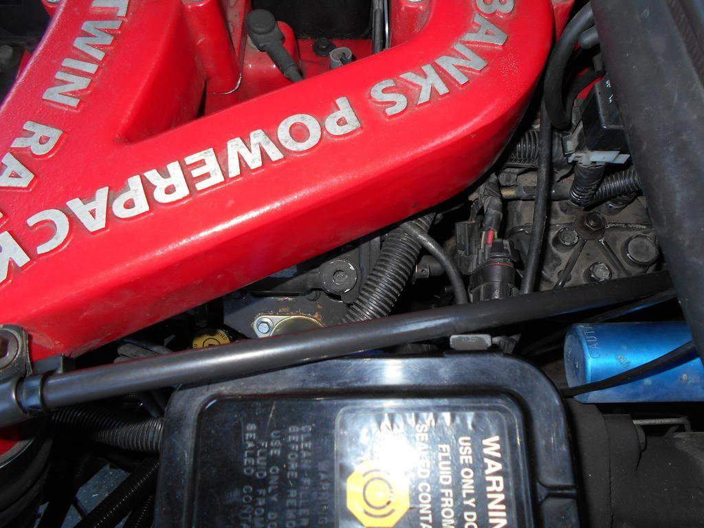

I'm getting ready to replace both rubber fuel lines. I think if I remove the fuel filter it should give me the room I need, is their anything else that would help.I have the double ram intake from Banks, and didn't know if taking that off would give me any more room ,to get to the return line.
The return line goes from metal to rubber right at the back of the injection pump, I THINK. Removal of the intake horn will probably be necessary. Also, I THINK the metal return line off the OFV actually bolts to the bottom of the injection pump. If so you can probably take the bolts out and remove the metal line with the OFV removed. I'm not sure about that, though.
