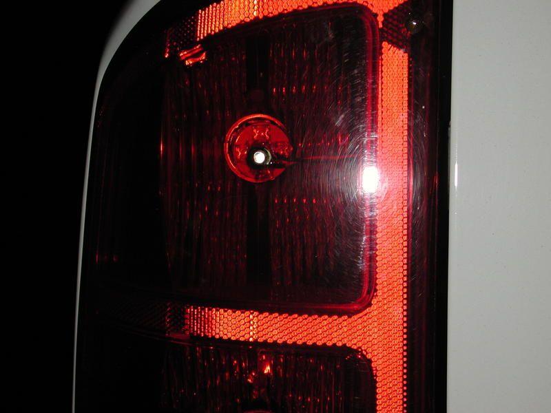

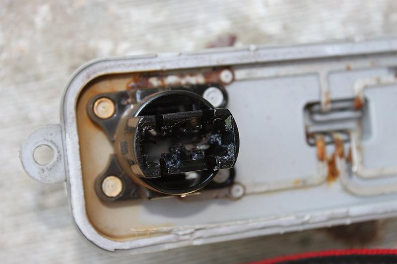

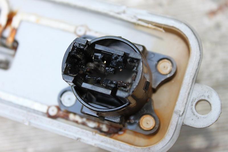

Common problem with these years. I'm sure this has been posted before. My drivers side backup light was out but a new bulb did not fix it. Seems like the contacts overheat and destroy the connector.....

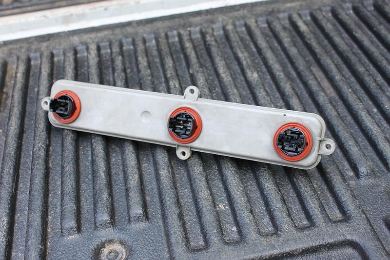

Replaced the plastic bulb holder with a new one. They are pretty cheap, like $12.

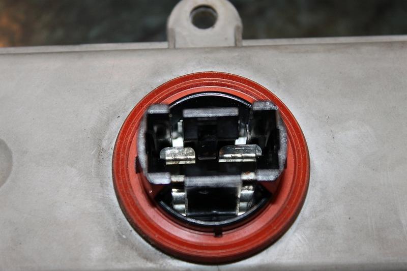

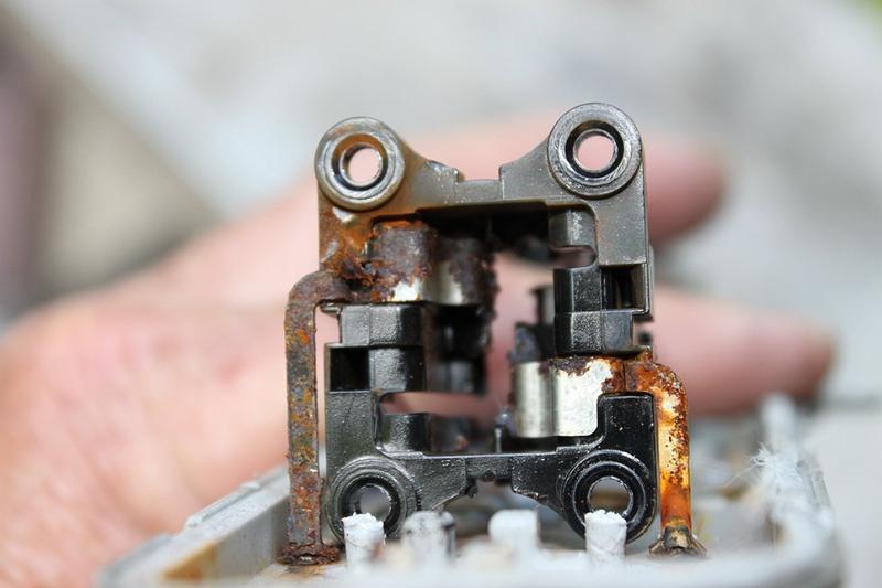

This is what a good one looks like..

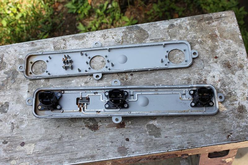

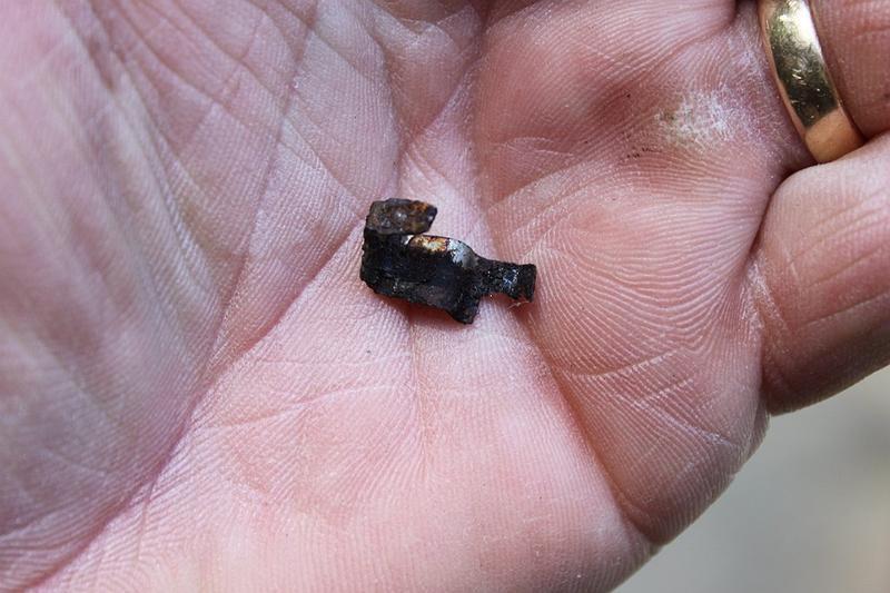

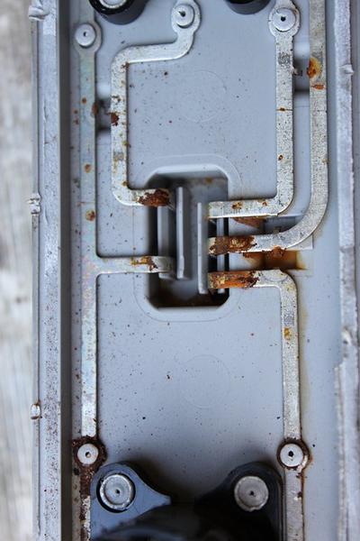

Here is a sequence of the bad on after I broke the strip open...
