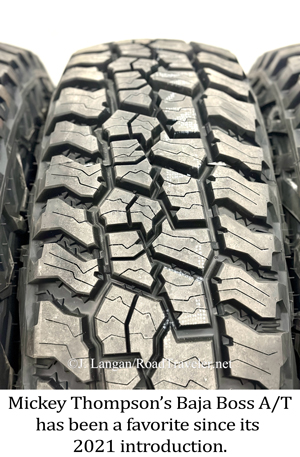

The Baja Boss A/T is a fairly high-void, four-rib tread design that Mickey Thompson calls a hybrid, AKA a commercial traction or an aggressive all-terrain. Absorbed by sister brand Mickey Thompson a few years ago, the legendary but now defunct Dick Cepek company arguably invented the first hybrid tread in 1978, when Mr. Dick Cepek introduced the first Fun Country. This was long before anyone used the word hybrid to describe tires, and before other manufacturers started emulating these versatile and multifaceted designs.
The Baja Boss A/T is a fairly high-void, four-rib tread design that Mickey Thompson calls a hybrid, AKA a commercial traction or an aggressive all-terrain. Absorbed by sister brand Mickey Thompson a few years ago, the legendary but now defunct Dick Cepek company arguably invented the first hybrid tread in 1978, when Mr. Dick Cepek introduced the first Fun Country. This was long before anyone used the word hybrid to describe tires, and before other manufacturers started emulating these versatile and multifaceted designs.​
Continually reducing road noise while improving other benefits of traction designs is a challenge for engineers. Historically there’s been no easy solution, because better traction in sloppy conditions requires bigger blocks and voids, which increases road noise. The Baja Boss A/T is quieter than it looks.
ACCORDING TO MICKEY THOMPSON
Mickey Thompson says the Baja Boss A/T blends Extreme Sidebiters® for a bold look and serious grip with an all-new silica-reinforced compound providing long-wear, all-weather performance and cut/chip resistance.

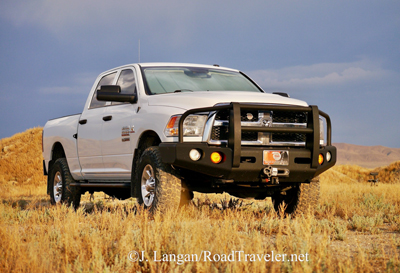

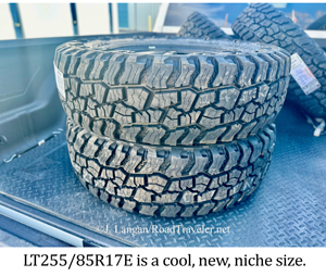

That last bullet point is the specific size this review is about, the LT255/85R17E Baja Boss A/T (also know as the 35x10.00R17LT). The substantial siping helps achieve the severe winter rating and increases overall grip, and measures a whopping 17/32” of the total 18.5/32” depth. Calling the sidewall rubber Extreme Sidebiters® is not an exaggeration, as they are up to 14/32” thick!
LT255/85R17E FOR DUALLYS
Dual Rear Wheel (DRW) pickups have an import role in the heavy-duty market, above the more common and very capable single rear wheel (SRW) HD trucks, but a notch below what are really medium-dutys, the 4500 and 5500 chassis. But the rear duals greatly restrict aftermarket tire options due to the spacing needed between sidewalls.
Unless someone wants to have their outside tires protruding well beyond the fenders (some do, and they think it looks cool), the DRW crowd has few choices for taller rubber that will fit otherwise stock or lightly-modified trucks. Mickey Thompson invented the new LT255/85R17E size to fill this niche. It is 35-inch-tall (34.6”), and was purposely designed to fit narrow 6.5-inch dually wheels, though it works well on wheels up to eight inches wide for SRW pickups.
When inflated to 80 psi, the 121 load-index supports 3,195 pounds each in SRW applications, or 2,910 pounds for duals. The tread has one nylon, two steel, and three polyester plies, the sidewall construction has three polyester plies, and they are made in the U.S.A.
SINGLE REAR WHEEL USE

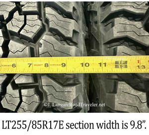

Narrower tires will almost always clear more easily with fewer and sometimes zero modifications than a wider tire of the same height. What is also routinely overlooked because many are focused on looks, and wider is perceived as tougher and better, is that a narrower footprint usually rolls down the road more consistently, catching fewer edges, rain grooves, or semi-truck ruts. There are some people that still prefer the appearance and performance of moderate width tires (few modern LT tires are actually narrow or small), and avoid negative-offset wheels or grossly wide rubber sticking well beyond the fenders, which sling rain, snow, mud and other debris.
So it was not surprising to hear Senior Project Manager, Light Truck Division at Mickey Thompson, Ben Anderson, say that the Baja Boss A/T in LT255/85R17E has become popular with the Jeep and Toyota crowd, and others wanting taller but not needlessly wide off-road meats for their four-wheel-drives. I’m also one of those folks.

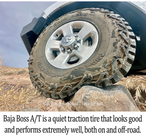

NOT LOUD
The lack of noise from the Baja Boss A/T for the amount of void and traction impressed me back in 2021. There are similar, older treads that I still like and have run extensively in multiple sizes on several four-wheel-drives, and the Cooper Discover S/T MAXX is a great example. The S/T MAXX is a little louder when new, but once they are worn the volume increases substantially, sometimes becoming nearly as loud as a mud-terrain. The Baja Boss A/T starts and remains quieter than others, and the engineers really deserve credit. Are they as quiet as a five-rib A/T or highway tread? Of course not. As with all tires, to help reduce noise and keep your rubber wearing evenly, frequent and consistent rotations are necessary.

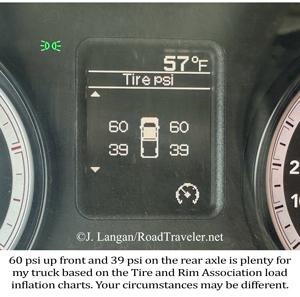

When unloaded I routinely run my rears between 35 and 40 psi for comfort, traction, and overall performance. The fairly soft riding 2014-and-newer Ram 2500s are not nearly as rough as the older and stiffer suspensions, but it’s still suboptimal to have overinflated tires. The ride quality difference between 80 and 40 psi with no load on the rear axle is dramatic. Over-inflation hurts grip and uneven wear is also possible.
Depending on the exact size, load index 121 tires will have a capacity of about 1,950 pounds each, or 3,900 pounds per axle at 35 psi, more than many think. One can always increase pressure to tune for their speed, ride, and overall preferences. Tires get hotter in warm weather and at higher speeds, and overheated tires can and do separate. Increasing psi for certain conditions might be desirable, but that doesn’t mean jumping from 35 psi to 80 when there is only 3,500 pounds on the axle.
In the front I typically run between 50 and 60 psi depending on the ratings and weight. The Cummins Turbo Diesel is heavy, but front axle loads are less variable so pressure adjustments are rarely needed.

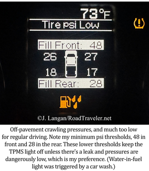

LIGHT LOAD TPMS LIGHT
The federally mandated Tire Pressure Monitoring System (TPMS) is an outgrowth of the Ford Explorer/Firestone debacle in the 1990s. It's also symbolic of a larger problem, which is the unwillingness of the average driver to take responsibility for their machinery, including failing to check something as fundamentally important as tire pressure. Even with TPMS on my pickups, I regularly check and adjust pressures with a handheld gauge.
Having psi information available on the dash is great, but it’s unfortunate that Ram eliminated the light-load option around 2012, and require all 2500 owners to run pressures for maximum loads or accept a warning light on the dash. The 3500 Rams have a different system, the Tire Pressure Information System (TPIS), because their GVWR is over 10,000 pounds. TPIS provides information but does not force a warning light for running less than a predetermined and maximum pressure.
I permanently eliminated the TPMS irritant with a professional Autel MaxiSys MS906 tablet scan tool. One could argue that this was a $1,000 sledgehammer solution to dispatch an ant. True, but I purchased the Autel one year before the AlphaOBD diagnostic software was available, which reportedly works well for adjusting the pressure thresholds.
A professional automotive tablet is a super powerful diagnostic tool, and I have only used a small fraction of its capabilities. But the scanner has come in handy a few times by allowing me to discover the source of unusual problems or clear codes that were too much for my Edge CTS2.
Regardless of the tool being used, I absolutely love being able to adjust the minimum psi thresholds for both the front and rear axles to my liking, depending on the load index of the tires and my needs. My 2017 regular cab has a heavy flatbed camper mounted full-time and the rear axle threshold's are set higher, usually around 70 or 80 psi.

Traction, handling, and overall performance from the Baja Boss A/T has been impressive in all conditions and on every surface, which has included considerable dirt, gravel, rock, rain, and snow. For those wanting hybrid or commercial traction rubber I don't envision many people wanting more grip over varied terrain than these Mickey Thompsons provide. My first set of Baja Boss A/T saw less snow than I would have preferred, not taking advantage of the three peak mountain snowflake (3PMS) rating because our local Sierra Nevada winter storms and my travels rarely overlapped in 2021.The story is dramatically different with the second set.
GOT SNOW AND RAIN? LOTS OF IT?
The day after mounting these LT255/85R17E on my 2014 crew cab, I made a 500 mile weekend round trip that included two crossings of the Sierra Nevada’s infamous Donner Pass. There were several inches of wet snow for dozens of miles that required four-wheel-drive. Followed by 100 miles of epic rainfall. The kind of rain that even with the windshield wipers bouncing at full speed I could barely see the roadway, similar to dangerous fog conditions, and using four-wheel-drive was beneficial because of water on the road. Throughout the remainder of winter and spring 2024, the Baja Boss A/T performed perfectly during every winter storm.
Similar to mud, the types of snow and the related driving conditions can vary greatly by region or microclimate, and opinions regarding what is good performance in certain conditions are highly subjective. For my uses I have found that the Mickey Thompson Baja Boss A/T are an excellent winter and wet weather performer under my Ram 2500.

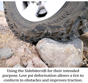

SIDEBITERS®
Sidewall tread has become popular in recent years, even on tires that are really not intended to be used in harsh off-pavement conditions because it looks cool. However, the Baja Boss A/T Extreme Sidebiters® are legit, and are super thick and beefy. I certainly like how they look, but also put them to work for their intended purpose. If you never leave the pavement, the Sidebiters® aren't going to complain if you drag them along curbs.

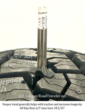

These LT255/85R17 Baja Boss A/T were mounted February 2024, have been rotated twice, and have logged 6,300 miles. Approximately 10% of those were off-pavement, including dozens at low trail pressures to improve ride, traction, and prevent damage. There is zero visible cutting, chipping or lug tearing of the tread, which is impressive considering the amount of off-highway use my truck sees. (Again, driving habits matter, and I keep tire slip and spinning to a minimum, particularly in the dirt.)
While I am smooth and conservative off-pavement, on the blacktop I routinely use all of the torque, horsepower, and rpm that my G56 version of the Cummins 6.7L has to offer with assertive application of the skinny pedal. Just like hard braking and turning fast can disproportionately wear the fronts, the massive twist of modern diesel engines can be hard on the rear drivers. Yet, that is not what I’ve experienced, there has been no penalty for my lead foot.
All Baja Boss A/T come with 18.5/32” of tread, and this set currently has about 15.5/32”, so they have given 2,100 miles per 1/32”. Those 2,100 miles compare well with other quality aftermarket traction designs, on the same truck, driven by me.
For comparison, my previous set of Baja Boss A/T in 295/70R18 were run for 15,000 miles and delivered 2,300 miles for each thirty-second before they started living on a friend’s 1991 W250 Turbo Diesel. If 2,100 miles per 1/32” remains constant, these LT255/85R17 Baja Boss will last 36,800 miles before reaching the minimum legal depth of 2/32”.
