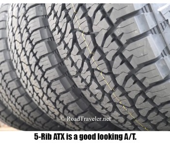

Nexen’s Roadian ATX all-terrain is a new 5-rib tread designed specifically for light- and heavy-duty pickups and full-size SUV wagons, and available in a whopping 63 sizes. Lugs on the upper sidewall/shoulder offer both traction and protection from damage, while adding a tough and aggressive look. The shoulder lugs are the same on both sides, but one side adds a cobblestone pattern between the lugs and inside the raised black letters.
All LT-sizes have 16/32” of tread depth, most have 3-ply sidewalls, as well as being 3-Peak Mountain Snowflake (3PMSF) severe winter rated, with the exception of the larger flotation offerings. Light-truck sizes have a substantial 60,000 miles tread warranty.

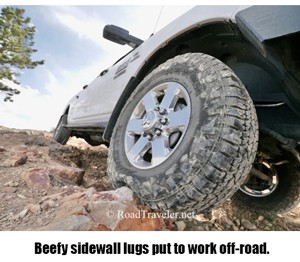

Nexen boasts the ATX has an industry-best for an all-terrain reinforced 3-ply sidewall, a longer tread life, and increased durability which performs well under heavier loads and at higher pressures. The increased rigidity is designed to enhance cornering stability and load support. The sidewall construction increases puncture resistance both on- and off-pavement, and the aggressively angled shoulder lugs improve durability.

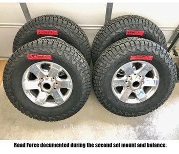

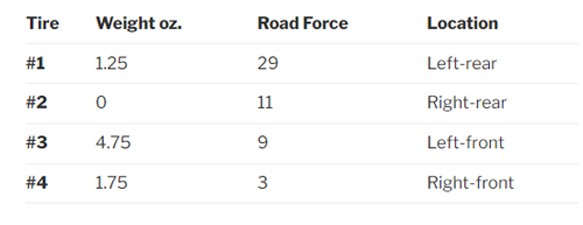

Discount Tire mounted the replacement set of LT285/75R18 Nexen ATX, and again I requested a static, single-plane balance, plus I asked them to record the road force as measured by the machine during the process. (See the sidebar for more on road force.)
As the chart below shows, this set needed little weight to balance, none in the case of tire/wheel combination #2, and the road force measurements were also low. Tire #1 had the most road force at 29, but a typical maximum allowable road force for a P-rated tire is 35, and much higher for a big LT tire.
Where The Rubber Meets the Road
Conventional wisdom includes putting the best tire and wheel combination (least wheel weight and/or road force) on the front axle, often the left-front position, to avoid poor drivability, handling, or driver complaints. But, I am not an employee at a tire shop. I put the mounted rubber onto the axle studs myself in my shop, and am often interested in the rawest, most revealing data possible for my reviews.
So, I will frequently put what is likely the least true assembly on the front. This helps me confirm that they are truly balanced, and will roll smoothly at all speeds, even after a rotation. These Nexen ATX felt fantastically smooth and true, with no bad manners or vibrations up to 100mph!
After an initial 50-mile high-speed freeway flogging, I returned to my garage and immediately did an X-pattern rotation to get every tire on both the front and rear axles, and both left and right sides of the truck. Another high-speed freeway road test followed, and the Roadian ATX continued to run flawlessly.

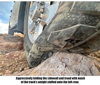

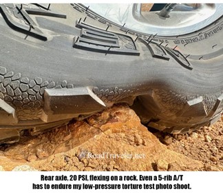

Routine off-pavement driving is a part of my lifestyle, so these ATX have seen hundreds of miles of high- and low-range four-wheel-drive use, usually with the pressures lowered specifically for that purpose (30psi in front and 20psi in the rear). Flex, deformation, ride, and traction have been great. Cutting or chipping of the tread appears virtually nonexistent.

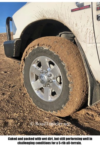

Clearly these are not mud-terrains, however, they have seen shallow mud and squishy terrain several times, and have performed as well or better than any 5-rib A/T I’ve experienced in all conditions.

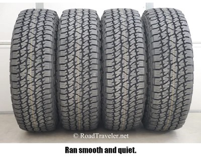

Perception of noise is extremely subjective, and has much to do with the specific vehicle, road conditions, plus one’s tolerance and personal experience baseline. If someone runs a highway-terrain tread, then anything with more void is going to seem loud. Conversely, those that run a mud-terrain or a hybrid/commercial traction design will think lower-void tires are nearly silent. With a preference for medium-void commercial traction treads, I find the ATX impressively quiet, but not only because I’m accustomed to slightly louder rubber. When comparing the ATX to my memories of testing the similar 5-rib Cooper AT3 and later AT3 XLT just a few years ago (TDR108), the ATX seems nearly silent.
Again, comparing the ATX to the Cooper AT3 XLT, the Nexen’s 3-ply sidewalls appear to provide a firmer, more supportive and responsive driving experience compared to the 2-ply Cooper. This is a positive for heavy-duty applications because softer tires will not support big loads as well and can flex too much, generating excess heat, which is the nemesis of all tires. Balance and tracking have remained excellent, but treads can exhibit different characteristics on different chassis, and your alignment settings matter too.
