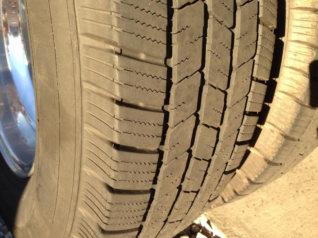

The Nexen Roadian AT (LT235/80R17) tires on my 2014 3500 Laramie CC Dually have a kind of faint rainbow ring around the circumference of each wheel. See picture. Reminds me of something that has been heated. Truck has about 3000 miles on the odometer, only ~300 of which was towing (maybe 21,000 lbs., haven’t had it weighted yet) with fronts @ 65 psi and rears @ 80 psi. Any thoughts?
Will it wash off? I seem to remember this happening to mine when I had a dually and was towing a large trailer and camper. If I remember correctly, it washed off and I assumed it was caused by heat.

OK! The word from local dealer service...the discoloration is caused by the finish on the Alcoa wheels bleeding onto the tires. It washes off the tires and the phenomena will cease after the wheels are washed a few more times.
