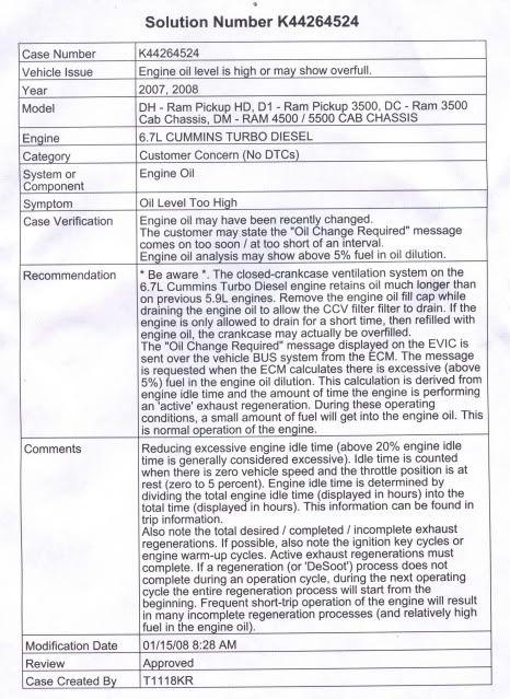

My statement was based on a service bulletin from Ram stating the cause of a rising oil level and early oil change light notice based on fuel dilution.
I guess you could include the amount and duration of regen cycles and % of fuel dilution in the duty cycle category if you like.
Dug this up. I could only find it in jpeg but it should do.
