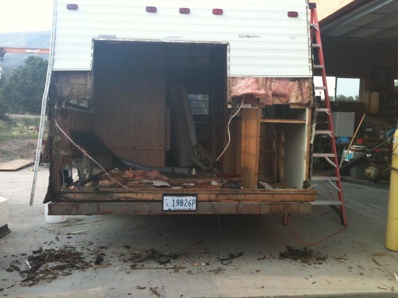

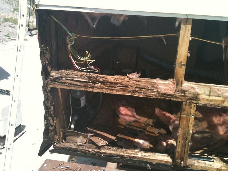

Back wall of my travel trailer.
CHECK your unit for any and all leaks!! The previous owner of this one did not and this is the result. Damage was hidden by quick fix repairs. The type of poor work leads me to believe it was done just prior to selling it to the "SUCKER OF THE YEAR" (me)! Yes, this is the same one with the broken black water tank. :eek:
This is a good "buyer beware" and maybe a reason to buy from a reputable dealer!
PLEASE, PLEASE, PLEASE, check your units for leaks. You DO NOT want this to happen to yours!
This is one of the reasons that I will never own a stapled,stick built, tin sided trailer. Way too many places for leaks,way too many places for rot to start. Hope you get it fixed.

Newt and RVTRKN: I have had it a year and a half and bought it in Mississippi (land of the lost) and yes, I suppose I could go to court, if I could raise the money. Won't happen because I only have S/S for an income. Thanks for the concern and good intentions but it is just my mess to clean up. I only posted it, with the idea that maybe someone else would do a good bit more checking than I did when buying from a private party. I blame myself for this, as I was in a hurry. The other reason for posting was, as I stated, Please, Please, Please constantly check your units for leaks, so this won't happen to it. It is all hidden in the walls and floors and surfaces suddenly. Thanks again, Jim

Water damage happens to the aluminum framed fiberglass RVs too if the seals aren't maintained. If water enters a seal, it will penetrate the pressure bonded/laminated plywood backing on the fiberglass walls and delaminate.

The seams may have been fine, I bought a 25' Prowler from my parents years ago and discovered a lot of rot. The water was coming in thru the metal siding. The siding had gotten small pin holes and they acted like siphons. So look for what appears to be small rock chips and apply some sealant to the holes.
