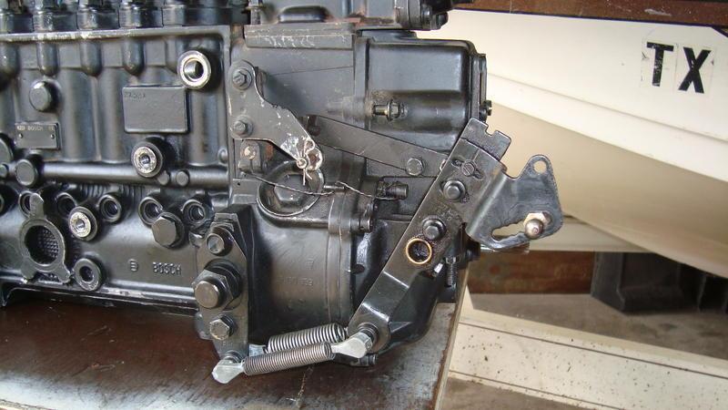

Although I don't believe the springs would cause RPM fluctuation, this is what the springs on your lower linkage should look like, except both springs will be the same size. One of mine is larger because I have a Jacob's exhaust brake.
