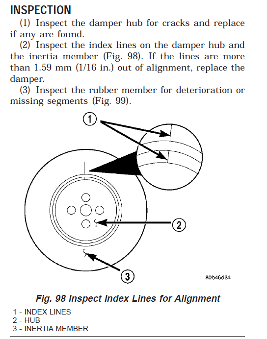

No need to rev and look at the damper, if you suspect its damaged, just check the alignment. there is a mark that'll be lined up if its good, also the rubber will be tight.

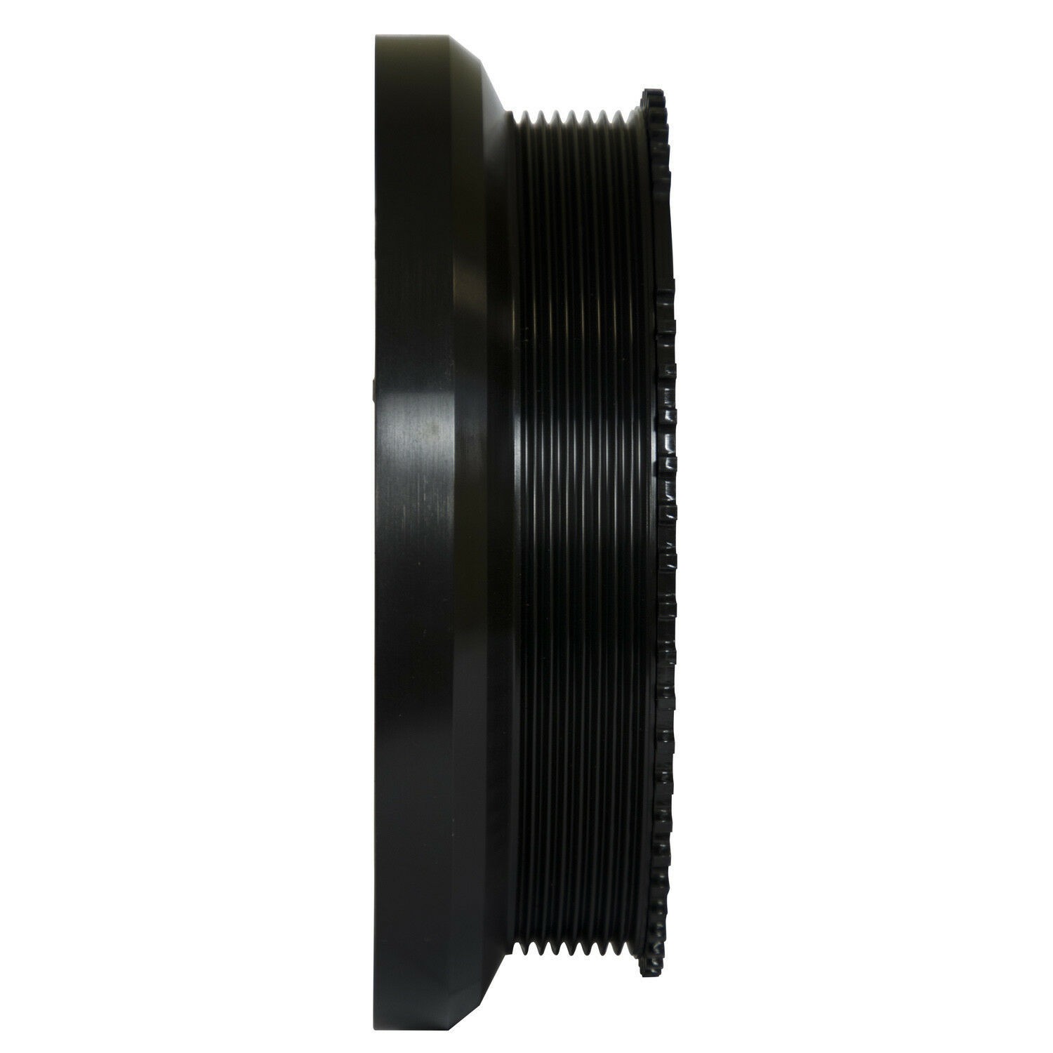

Consider installing a Fluidampr. I saw that you mentioned the 6.7 damper but the Fluidampr has a bevel cut on the back to enable belt installation (old ones don't, but they would have to be four or five year old stock.

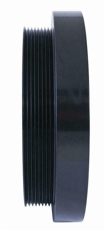

I can attest to the fact it makes a distinct difference in the feel and vibration levels of the engine, and the engine seems quieter too, all at least until you get accustom to it, then its normal. Damper on the left with the bevel is new, other is old. Verify with any seller than what you are getting has the bevel on it and the tone ring machined into it, and that it is fluidampr p/n 920301.
