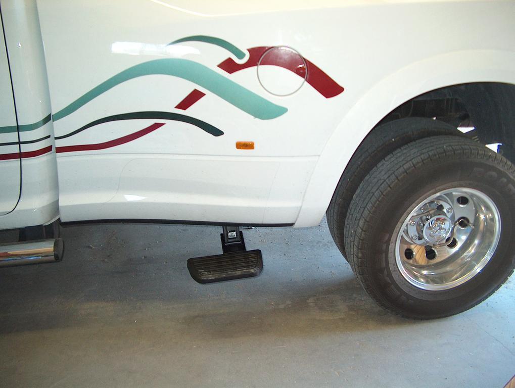

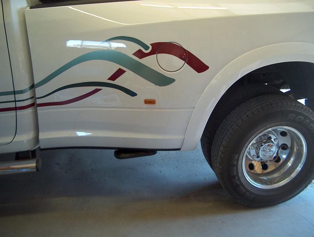

Build one of these.

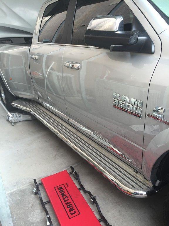

I have a 2014 3500 DRW and I installed Luverne running boards. They are heavy gauge stainless and have the flared dually box extension. I also had Luverne running boards on my 2004 dually and have never had a problem with them.

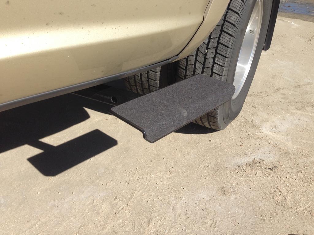

Wow they finally made them to be closer to the tire. I would shift the pad closer to the tire to make it easier to reach the 5er hitch.

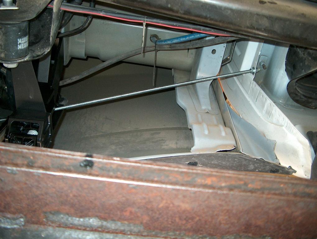

they were a little wobbly sideways so took a 30 inch length of 3/8 ready rod and tied them in toward the front. they are rock solid now.
