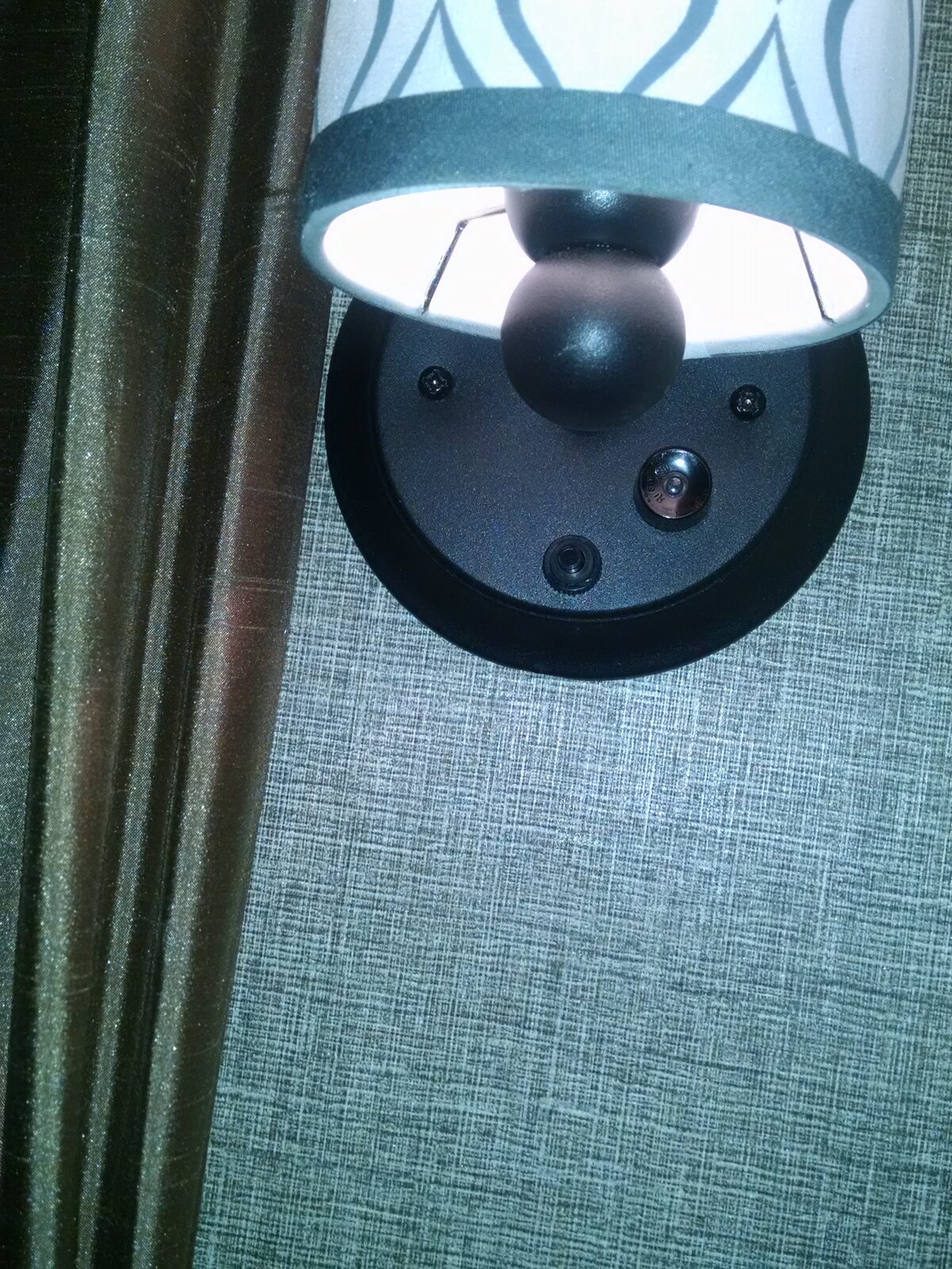

Running the camera power from running lights in quite a few cases causes low voltage to the camera. I added a on/off (round turn switch in picture) to a rear wall sconce light to my Furrion obersvation camera(as in you can have it on while driving) https://www.etrailer.com/dept-pg-RV_Camera_System-sf-Observation_Camera.aspx . I had a 39 foot 5th wheel and never had wifi distance issues. I could drive almost a city block away from the trailer without losing signal. You get what you pay for!
