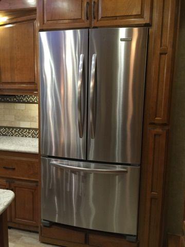

We have the Kitchenmaid and are VERY pleased with one full year of fulltiming under its best.
