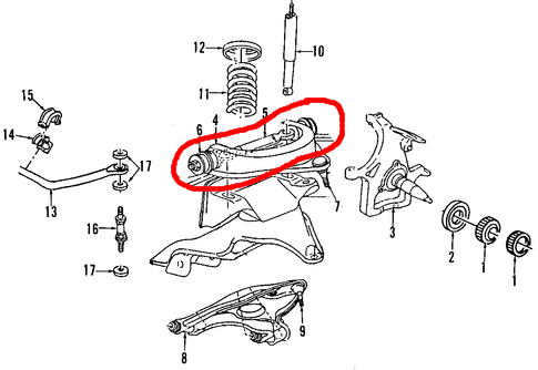

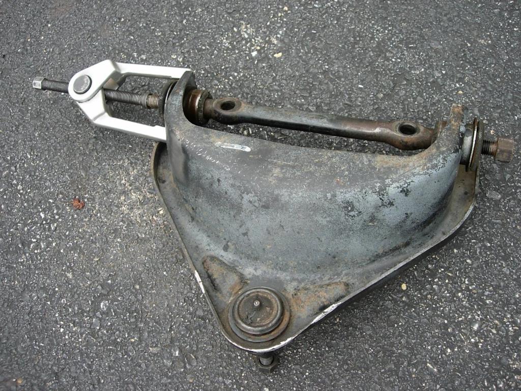

I finally have a replacement for my driver's side UCA. It's just as old [well, technically it's two years older] and worn as mine, but it doesn't have a wallowed out ball joint hole nor a welded ball joint attached to it! I ordered some bushings from Rock Auto, and I attempted to remove the pivot bar on my recently acquired UCA [not the one on the truck]. The FSM doesn't say anything about changing out the bushings on the UCA, nor does it mention removing the pivot bar. I've read several posts where folks said they changed out [rwd] control arm bushings, but none mentioned how.
Is the pivot bar supposed to be removed in order to access the bushings? I'm thinking perhaps not. It doesn't seem to be part of some turn-buckle style setup. Do I need a special slotted cup to press the old bushings out using a ball joint press?
I've been thinking along the wrong lines. A double jaw puller of the proper size just might do the trick. Sadly for me, I don't have one nearby, so it looks like I'm off to the parts store tomorrow.
Need Suggestions, Please!
Well, how do I get these blasted things off? As you'll see, the puller bent up the lip, and the bushing didn't budge.

Did you get them out?!?..... could always drill out old bushing with multiple passes then get a hacksaw or sawzall blade in there to cut out the metal sleeve.
Usually pressed out.

No. Haven't removed the old ones yet. Looks like burning them out [most of the bushing at least] seems to be a common solution for those without a hydraulic press. I'm temporarily in western VA now, so I've contacted a friend who has a friend who might have a hydraulic press. ... Yeah. I'll probably end up burning them out, removing the pivot bar, & then using a typical ball joint press for the remaining outer shell.

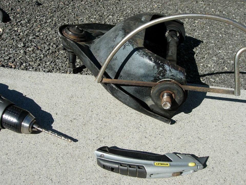

Bill, on the video where I watched him burn out the rubber portion, he used a hacksaw to almost cut through the outer shell. He then took a flathead screwdriver & used it as a chisel - like you mentioned. It worked!
I'll get to this, but not tomorrow. :) When I do, I'll make post for those few 2 wheelers out there who might do theirs down the road. What is the percentage of RWD vs 4WD? I know up north it's closes in on 100%, but what about the warmer latitudes? Perhaps I should stick with TDR members. 30-70?

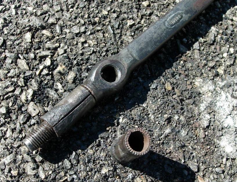

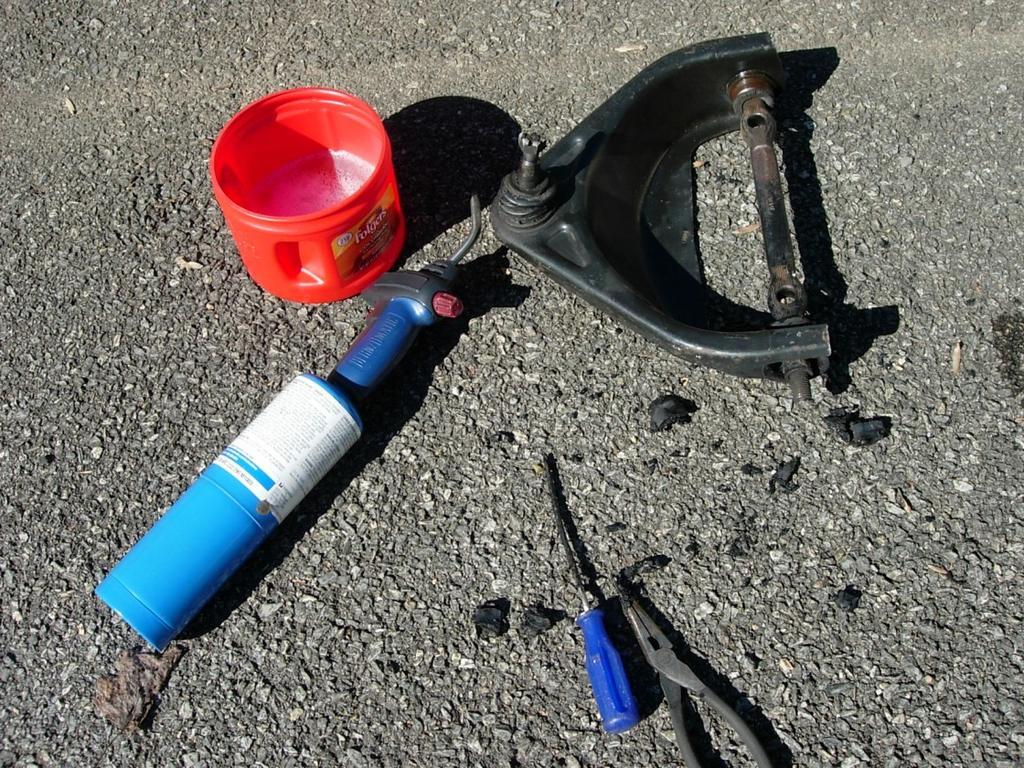

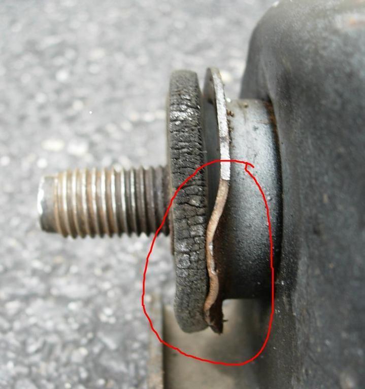

Successfully Removing The Pivot Bar
Notes:
1) Cutting off the extraneous rubber makes it easier for drilling holes.
2) Drilling holes makes the burning better. 6-8 will do nicely.
3) Burn both sides of the bushing. Takes just over 2 songs worth of applied heat to soften the rubber enough to pluck/push/remove it from the bushing.
4) It's messy, and it stinks. Should've laid some tin foil down on the asphalt in order to readily collect the easily smeared, half melted pieces of rubber.
5) Keep wearing gloves even after everything has cooled down. Small rubber bits spatter onto various things like the torch or the midpoint of the control arm, and when they cool down, they don't act like the solid rubber they came from - they act more like tar. It stains your fingers yellow regardless of the cleaning solution applied to your skin. [The stains go away in a couple of days.] A degreaser removes the splatter from metal objects.
6) You only have to clear all the rubber from one bushing. On the other, after sufficient heat, use the pivot bar to push the rubber [and the bar itself] out.

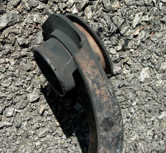

Oh yes. That inner metal part rusted itself to the pivot bar. Hammer & chisel. Getting that bugger off took longer than burning out the bushings. Squirt it down and keep tapping away on it. It'll come off.
Now that the pivot bar is out, a standard ball joint press extracts the remaining outer bushing shell.
Fine sand paper and some light sanding. A bit of grease and she's ready for fresh bushings.
