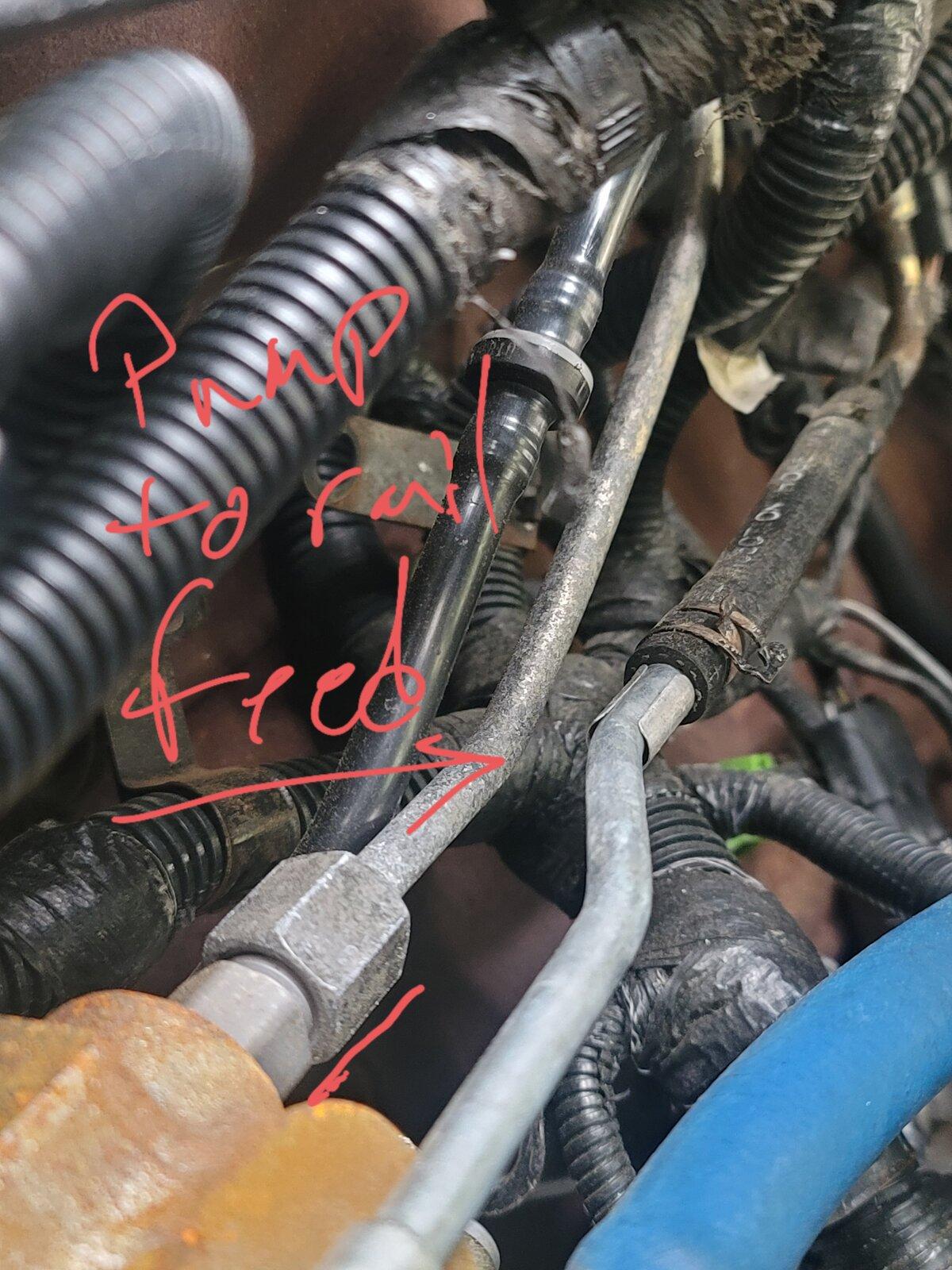

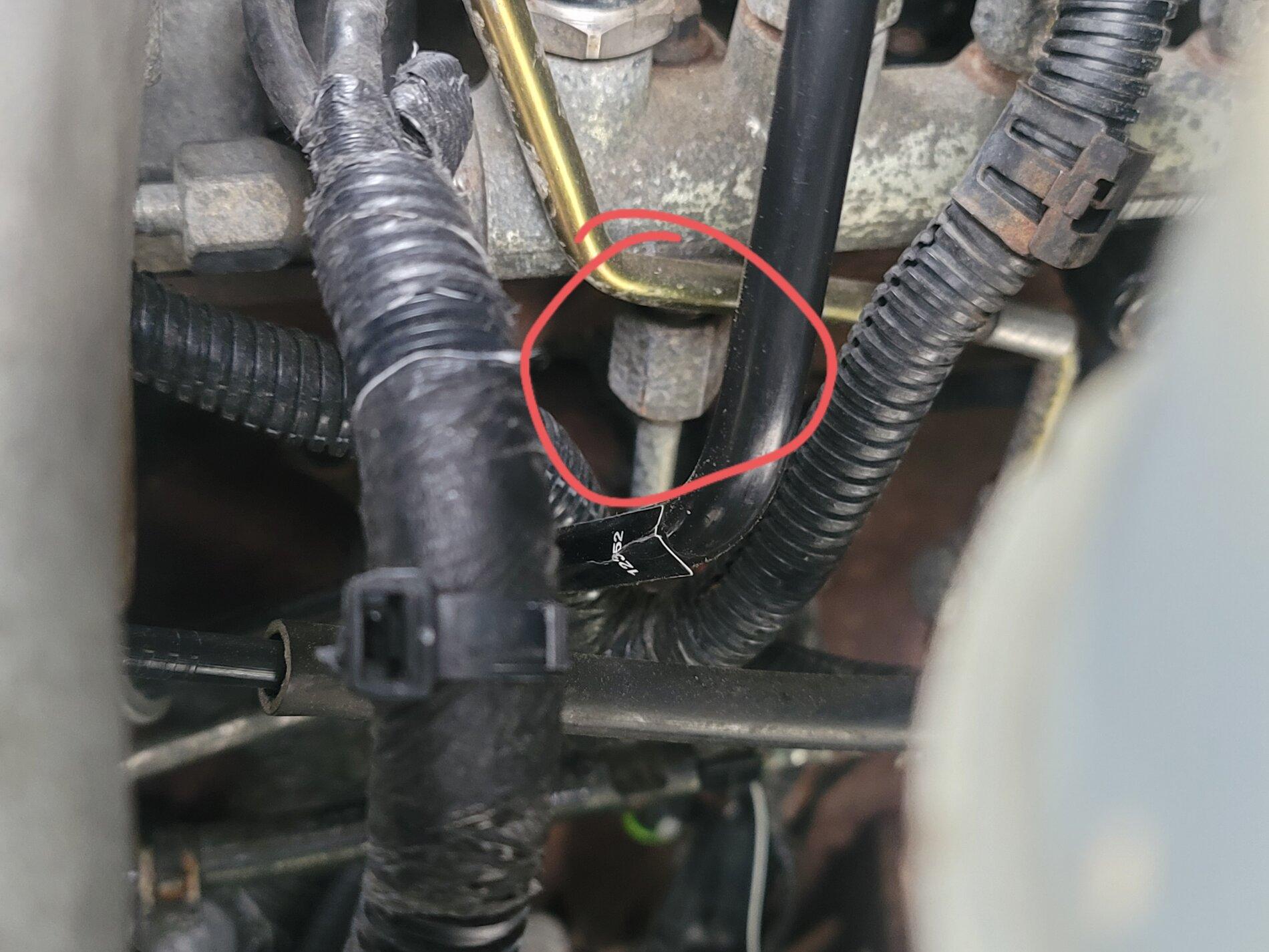

This pump itself drops in ok, you can remove the ccv drain for better clearance during install. What wasn't mentioned on any descriptions was that you have to modify the hardline going to the pump to the rail. I'll have pictures below. I was only told the pump supply had to be modified from the fuel filter housing. This wasn't so much an issue for me since I have a delete return block and an aftermarket lift pump.
I sent emails back and forth, asked them if they've tested this on an early 03 or 04 truck etc. etc. I'm told everything is as it should be and that all 5.9s need tweaking for this line. I would've liked to know this ahead of time or before I bought the pump and struggled with it.
So the solution is playing black smith with this line, since my truck is an early 03 my APPS is mounted on my throttle linkage assembly which is located on the manifold shelf. I remove it and reinstall the three bolts that hold it down and use those three bolts to as a pipe bender for this hardline I spent near two hours tweaking and test fitting this line back and forth until in threads in perfectly.

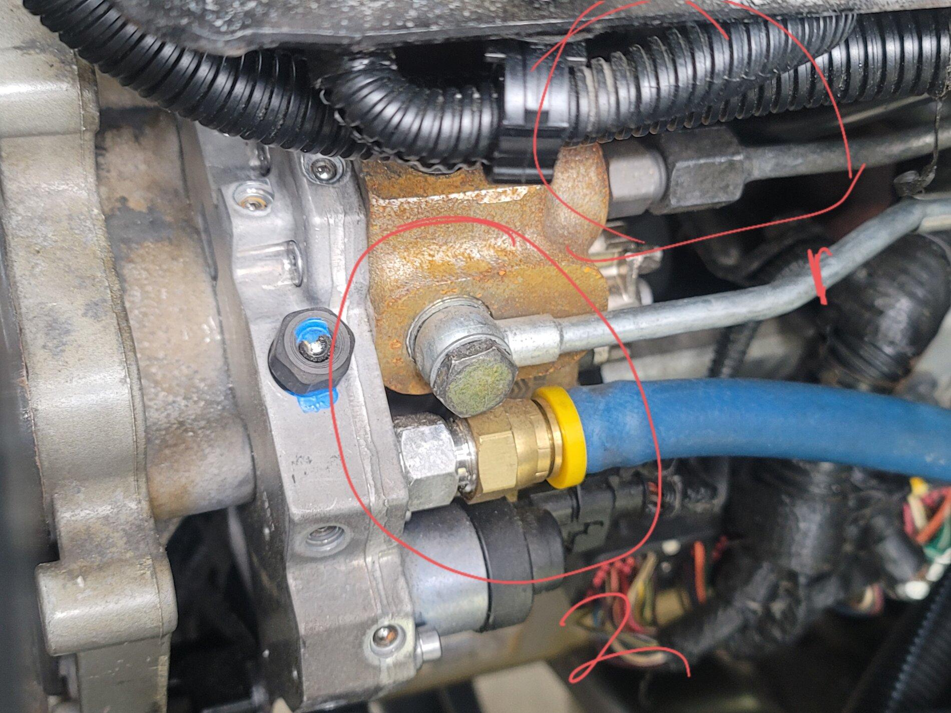

The last picture has two numbers 1 marks the pump to rail feed hardline, 2 marks the pump supply and return port. The clearance on these is pretty tight, you have to remove the return banjo to tighten the supply connector.
