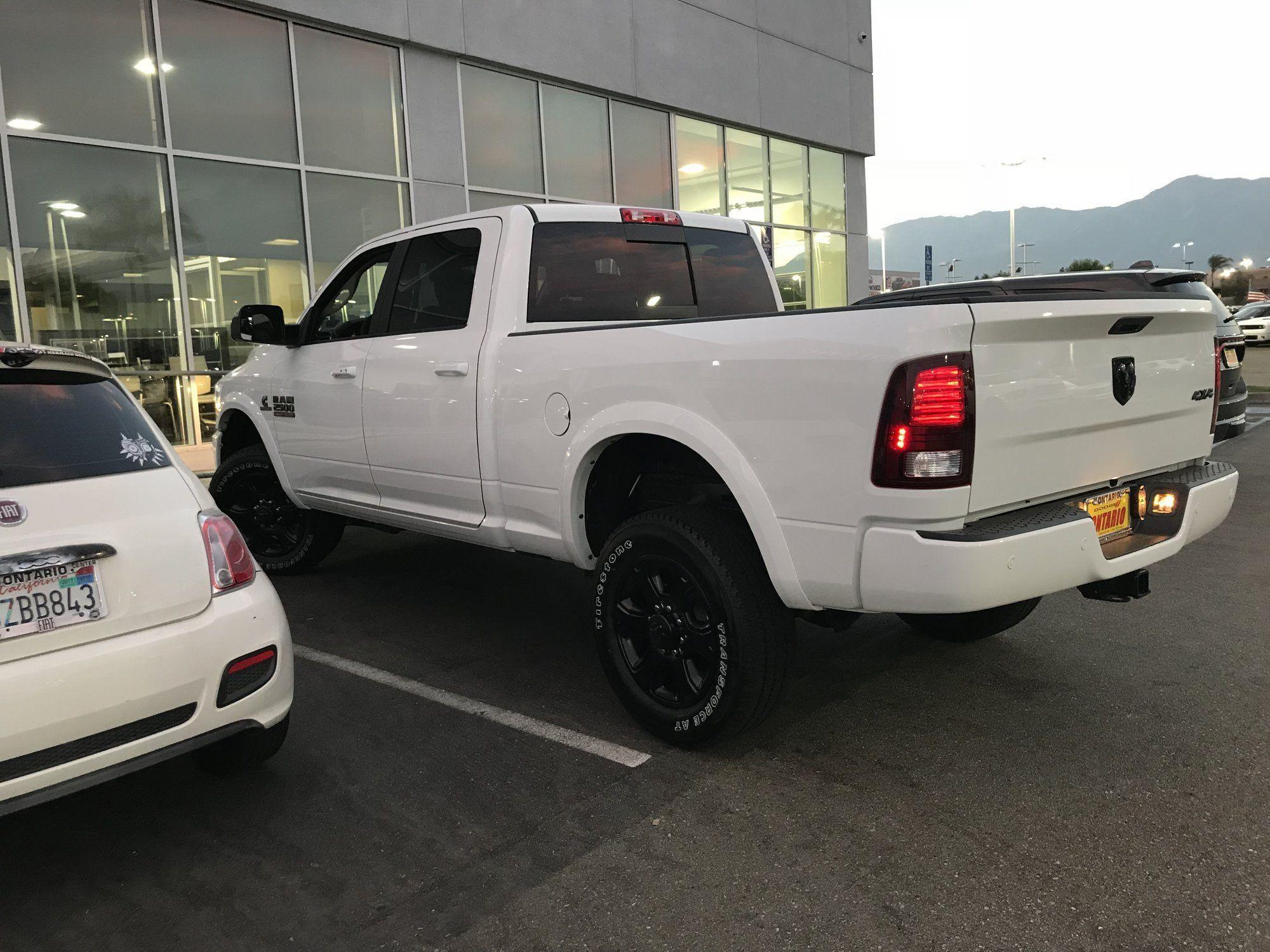

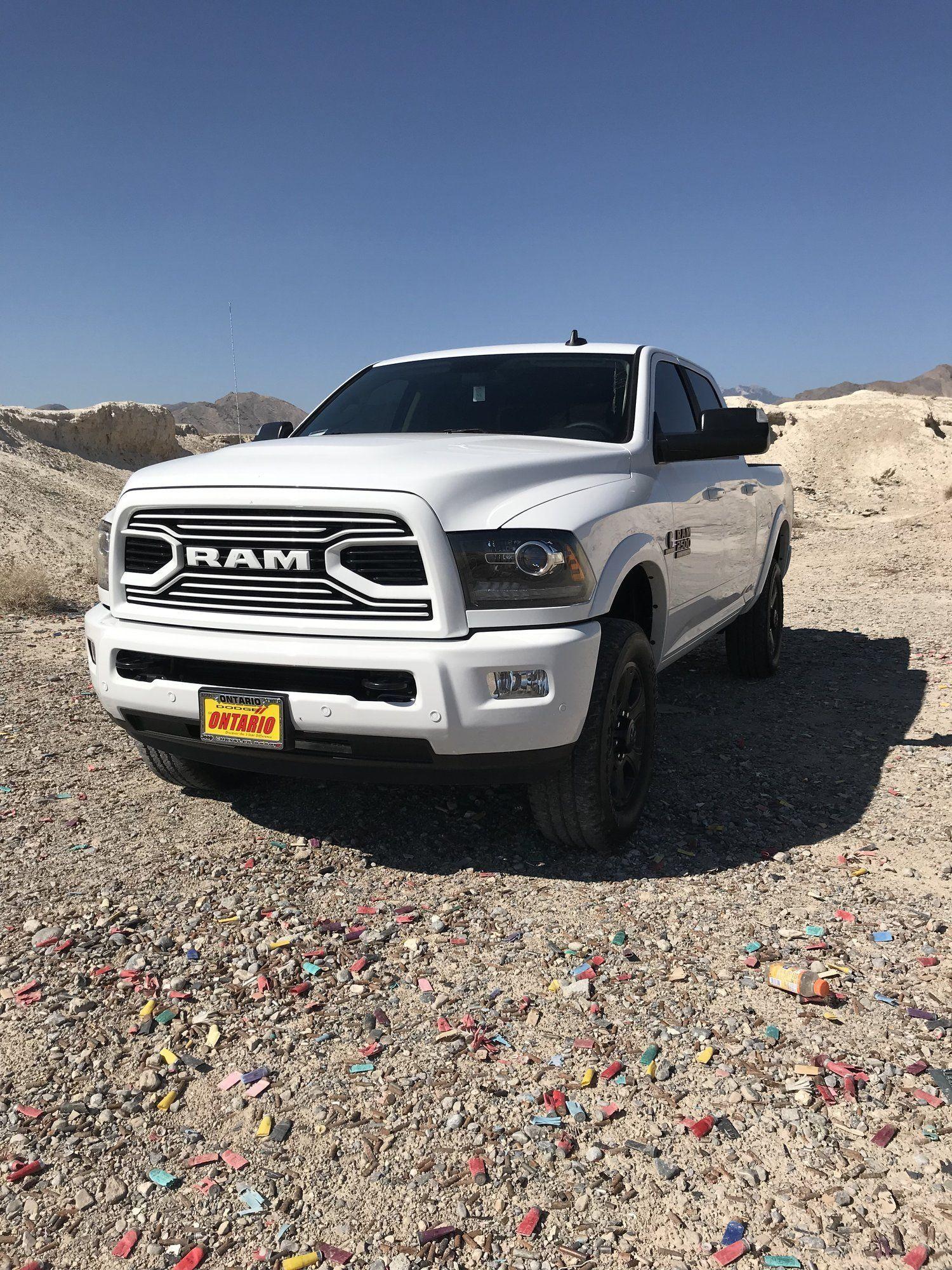

This is my truck
View attachment 108362 View attachment 108363 New to Diesels and bought my truck with 13 miles so I want to take great care of my dream truck.
Is it safe to let it idle with the AC on to keep wife and kids cool in the summer or is it better to shut it off and turn it back on all the time?
This is my truck

Nice truck, by the way
