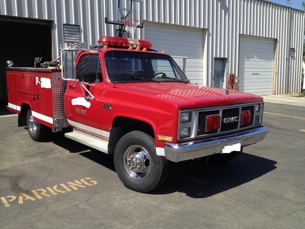

Here's the said patrol. Super clean!
Wow, super clean and a great deal for your department! You don't know how lucky you west coast guys are with your equipment. You would never find one in that condition around here.
I'm not sure if CA and PA standards for emergency equipment is the same, but there is a real advantage in buying from another department around here. If you purchase a currently in-service unit from another company, it can go in service with your company unchanged. There are some exceptions obviously, but if you would go out and and purchase a non-certified truck and try to put it in service, it would have to meet 2014 standards for lighting, safety equipment, etc. You would easily have the majority of that $3K asking price in lighting, radios, etc. alone.
Yes, it would be a TH400. There's a lot of life left in that truck. 25 years ago, we didn't have many trucks that size in any of our departments. Now, I think that almost every one of our stations have a mini-pumper or attack truck in that size. Very, very useful unit size and much more cost effective than running a traditional pumper out the door on everything like we used to.
Wow that's sweet! Yes that would be a rust bucket here. Prolly has D60 front ax and 205 case. Trans? T400?
