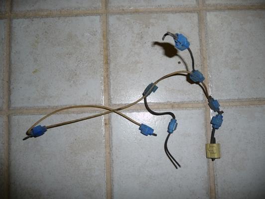

Scotchlocks can breed if left unchecked!
Don't tow in park!!!
This pic is positive proof that given two Scotchlocks, a quiet out of sight, dark, slightly dirty area that these little buggers can TAKE OVER your trailer wiring! These are obviously not the later model of dare I say "Fixed" Scothlocks that cannot breed.
While checking the rear diff on the '97, one of them even attacked me and tried to make a connection, but I was quicker than it was. Notice the pine straw food that these guys have stored up to get them through the winter, proof that they think and have master plans.
How to erridicate them? 3 requirements: un-insulated butt connectors, solder and heat shrink tubing will keep them at bay.

Refer back to the 1st picture for the before situation.

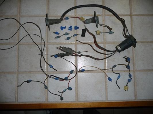

I finally got motivated to do something about the Scotchlock (SL) breeding grounds under the back of the '97. The license plate lights weren't working, no big deal, right? WRONG! The fragile sockets were kaput and actually available via Dorman HELPS, I bought two.
The nightmare began.
I looked at the old mess and reached for the cutters, scalpel, hemostat, forceps and a short time later the 3 trailer sockets, yards of crap wires and at least THIRTY ONE SL's were on the ground.
The reconstruction of the stock type 7 blade RV socket has to wait for correct cable.
The rest of the story involved finding what the he-doublehockeystick did the previous malicious flybynight SOB did to all of the wires! They even went up into the tail light harness at the sockets and put in more SL's and boys and girls seems like EVERY place that a SL was it turned into corrosion or even broken wires. The grounds had to be re-established and a slight modification to the supply for the running lights was "grafted" but the running lights now function via the light switch. Having a factory manual was a big help, me and chapter 8W spent some time together, Z13, L7 and L63 reported for duty.
The champion circuit had at least 9 SL's in a few inches of wiring.
