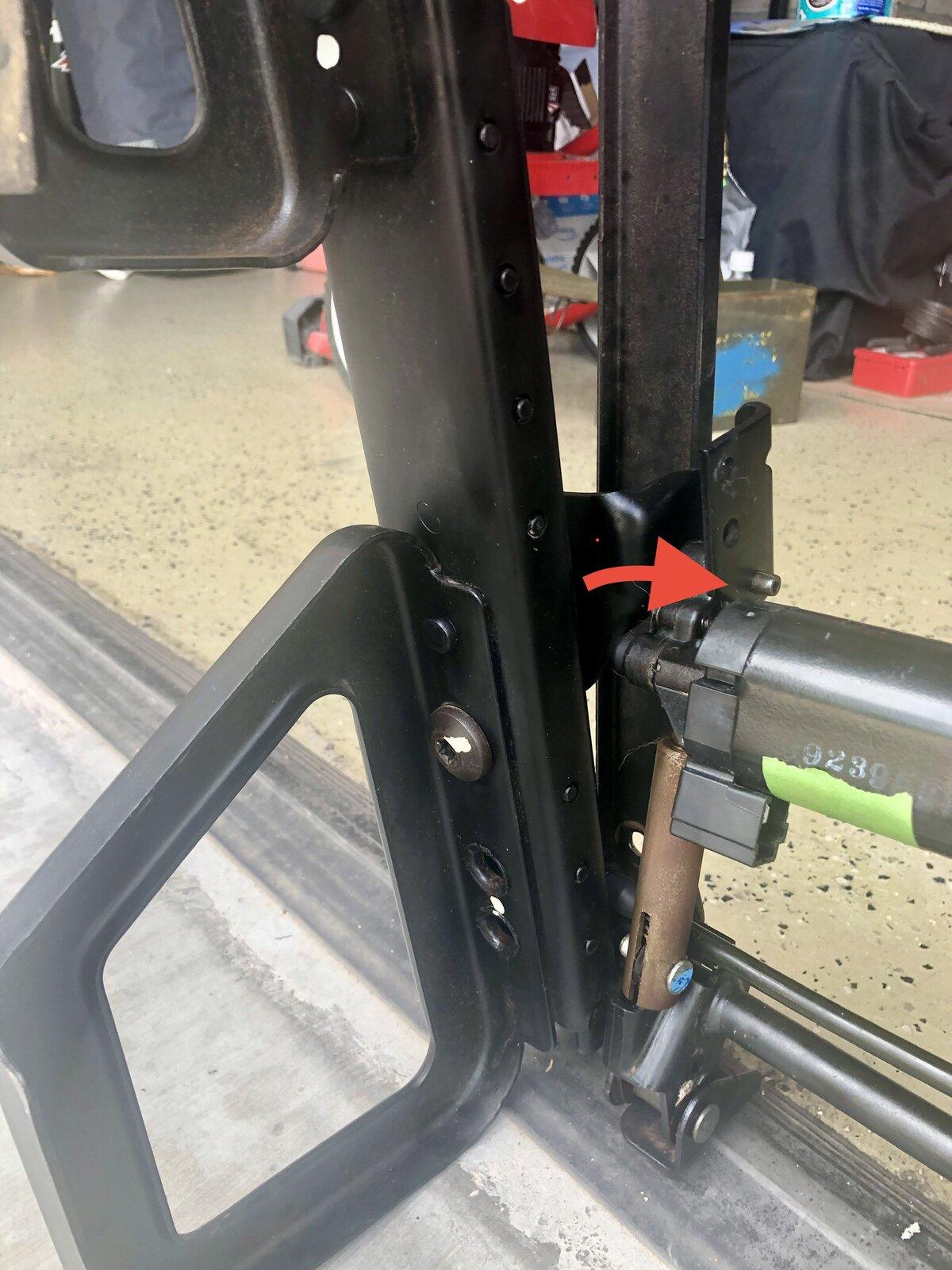

Did you have chance to sort out the issue with your power seat? I'm attempting to do so with my seat now. If so. could you share guidance for removing the motor and roll pin holding the motor to the seat bracket?
I came across the following from the TDR that may be of assistance.
https://www.turbodieselregister.com/threads/power-seat-motor-new.226676/#post-2185153
This is interesting and useful to me, because I have not done the repair yet. :rolleyes:
Edit: Having read the link, there doesn't seem to be anything about the roll pin. So, if it has to come out, it will probably require a pin punch, a ball peen hammer and some tapping. It'll go back in the same way, unless a bolt is used instead. But the roll pin was used for a reason.
I was able locate salvage yard find of the whole Driver LH Power Seat Track Base w/ the 3 motors that work. So I will not for now be attempting the replacement.
However, while gathering info in preparation of replacing one of the seat motors, I kept some notes from a seller on Ebay that regularly offers them.
https://www.ebay.com/str/twomenonegarage
My understanding is you may use a punch to push the metal roll pin out, when you punch it out, it will collapse a bit and then, putting it back in is basically the same. On the other end, you have a silver colored pin that needs to be punched out (with a bigger punch) as well. Then when it is off, there are two screws, either 1/4 inch or 3/16 of an inch. Unscrew those if you want to look inside. These motors, unlike later generations, do not have a keeper at the end, so you can literally unscrew the part that moves on the worm gear. This can make the movement a bit loose.
Also a pair of side cutter pliers can sometimes grip the pin and then you may use the pliers with leverage to get it moving. Also, vice grips may work.
