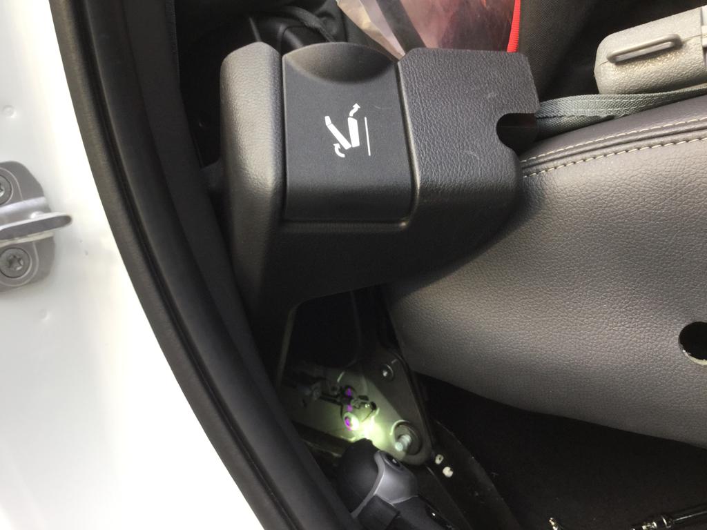

The procedure I used was to first remove the seat cover from the side I needed to work on. Just gently pull it up and the in towards the center of the truck and then down. It will come off of the frame and seat. You do not have to take the cover off of the seat, just losen it and pull it out of the way. Then remove the two 7mm bolts that hold the recliner cable assembly to the seat.

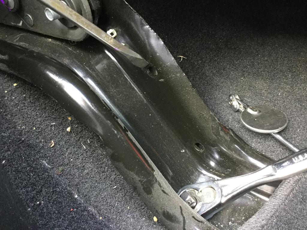

Next, remove the reach underneath the seat and remove two 7mm bolts (silver in color on my rig) that holds the larger lower black plastic seat lever housing in place. Then remove the black 8mm bolt located in the back of the plastic housing in a recessed hole.
Then, above the plastic housing along the seat back on the side of the seat I removed the 7mm black screw that holds the soft plastic hinge cover to the seat back. I did this so I could gently move the plastic lever housing up and out the the way.

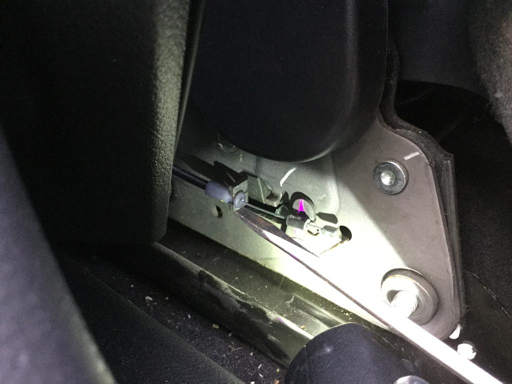

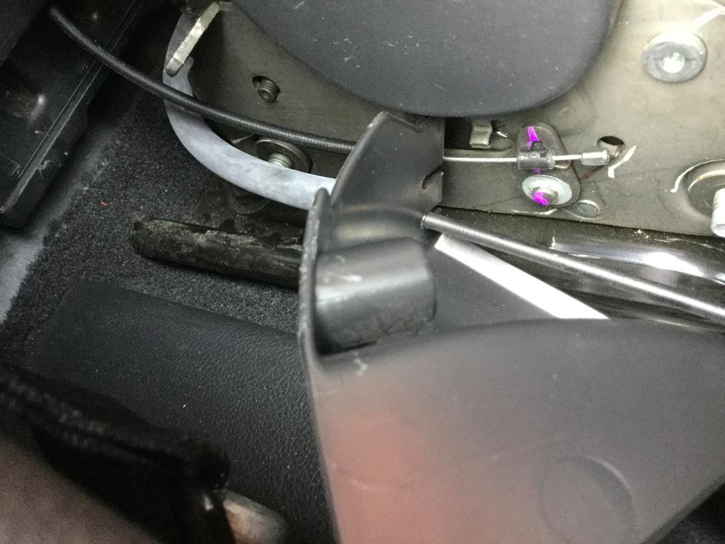

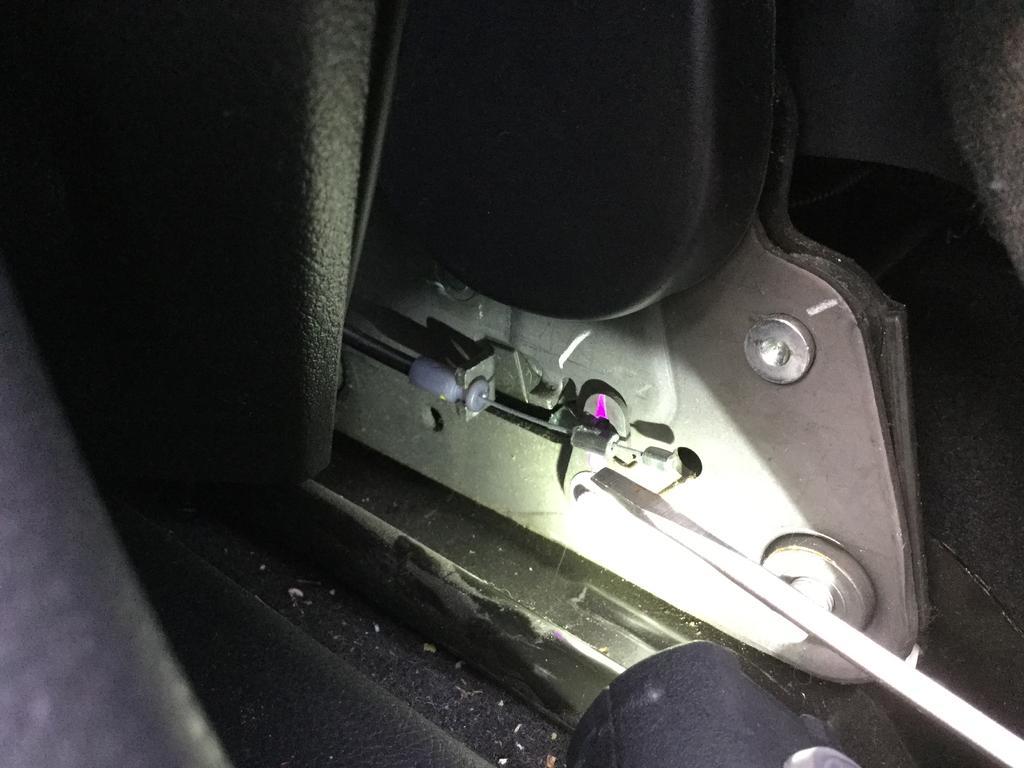

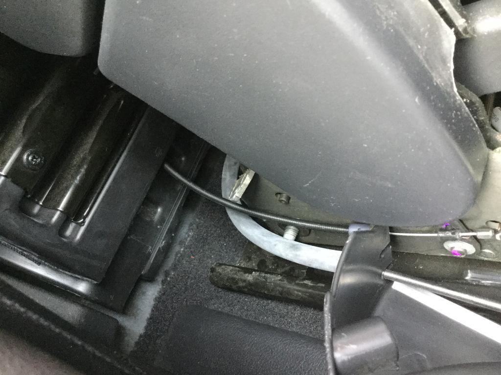

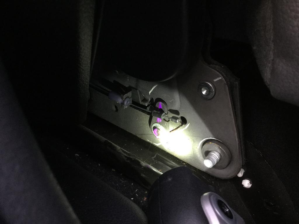

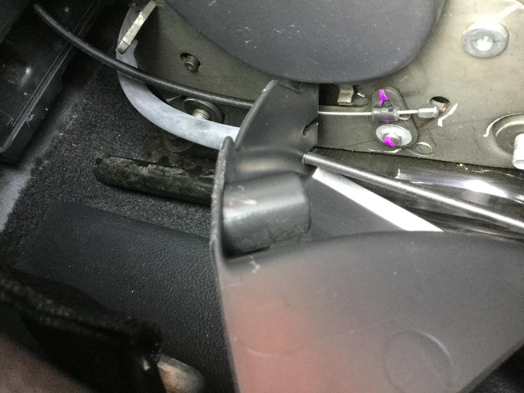

With the housing out of the way, I undid the cable end by turning the black plastic able end 90* and then gently pulling it out of its slot. Then I used a long bladed screwdriver to pop out the cable retainer. I threaded the new cable along the route of the old one and. Removed the old one, being careful to make sure the cable and protector sheath of the new one followed that of the old one.
Finally I re-assembled everything back the way it was.
