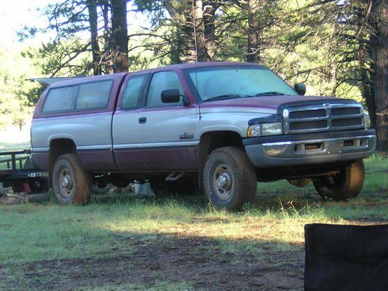

Here is my truck, paint is ALOT worse now.
Local auto paint shop quoted $500-ish for paint. No Can Do.
Factory colors had some pearl in them. NOT going to even attempt to match that. Just get close to the colors.
The tailgate is a good example of what was happening elsewhere on the truck paint a few years back.
Now the tailgate and both rear quarter panels have shed all of the original grey paint and have VERY thin primer left
Hmmm, belt sander and lots of wet sanding by hand... ... A good primer, sanding, and then some quality paint..... I'll try to upload some pics of one of my trailers later this evening... . I painted it with some Rustoleum Professional Machine Gray. It's ok, definitely not the color of Dodge's gray, but it's close... . The red may have to be IH red!! :-laf
