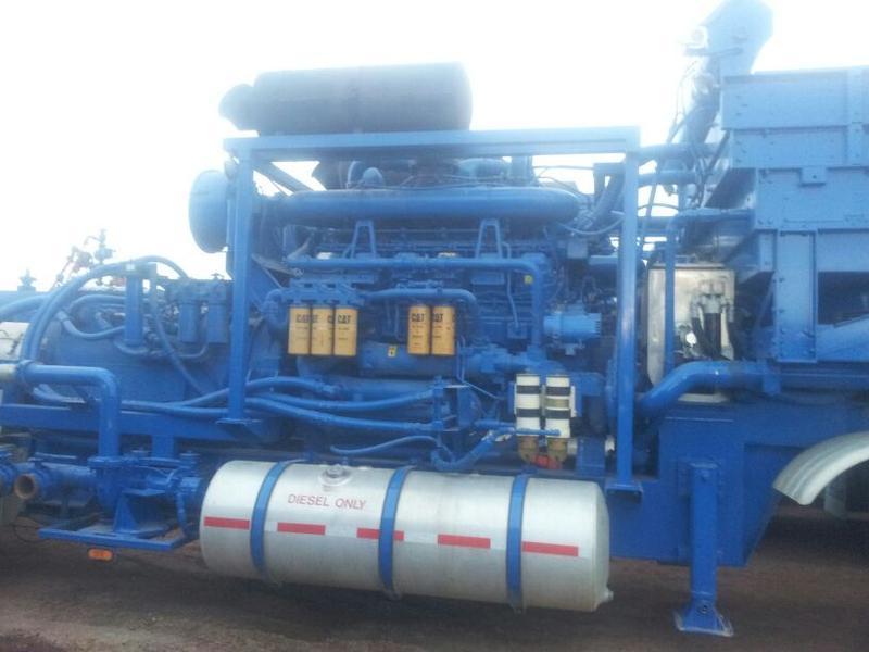

FYI, The only two industries that can "legally" get anything else besides ULSD are railroad and mining... #@$%!#@$%! They have to use what the tanker gives them when they need it and I'd bet they have used both types due to whatever was available at the time.
Even the oil/gas industry has had to bite the bullet and use ULSD when fuel is needed...
Notice the filter bowls on the water separator filters have green fuel in them :confused: Road tax paid for hundreds of gallons of fuel when they haven't moved a single inch for the last week!! #@$%!#@$%!
And to those of you that are wondering... 5 of the 7 filters are secondary and the white ones are primary/water separators.
I'm sure a CAT guru will chime in and correct me on this...
Mikey
Fuel tank ain't no where near that big,:-laf I used to have one of those white filters on my truck Racors are pretty good filters and Water separators back in the day. Course back then the motors would burn most anything that would.
