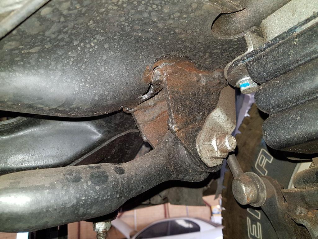

Hi all,
I'm not a regular contributor but hoping you may be able to help me nonetheless. I’m an Aussie who bought a 2014 Ram 3500 Cummins Aisin Megacab in the US and imported it into Australia through a right hand drive conversion company.

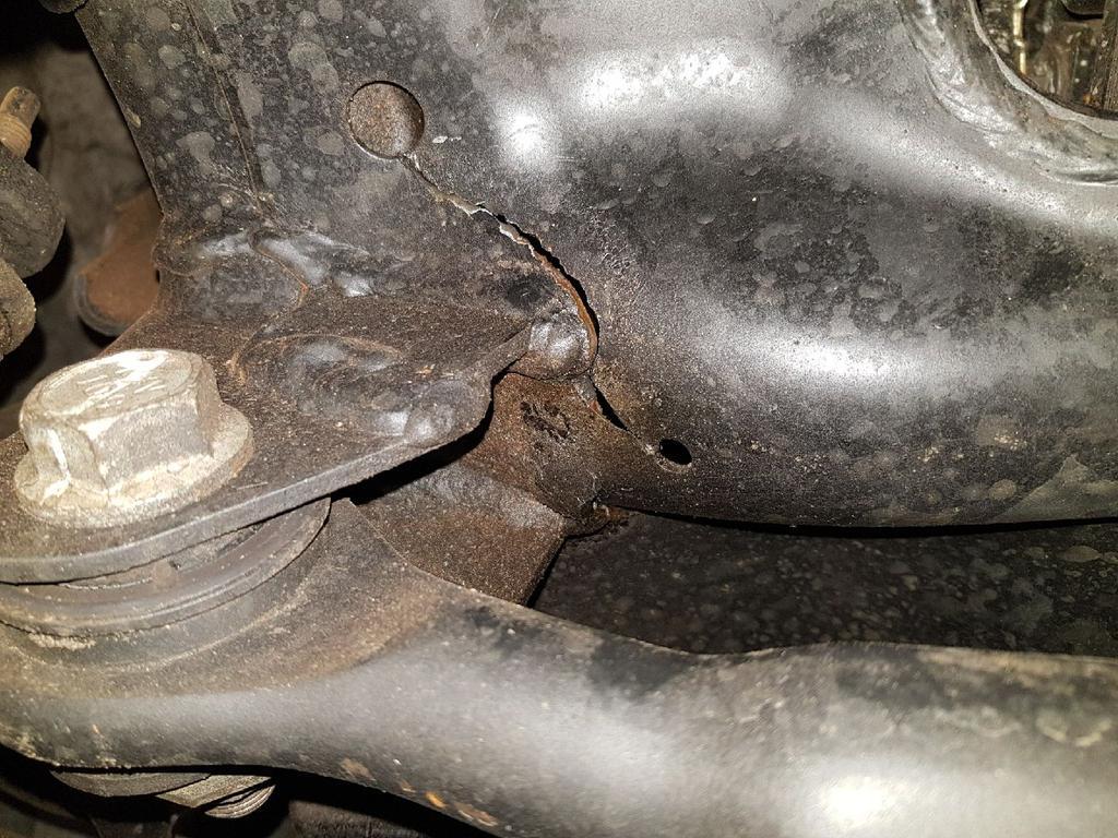

I’ve just discovered that the panhard rod mount on my truck is very seriously cracked. Basically 2/3 of the way to tearing right off the subframe. It’s all factory stuff, the converters didn’t touch these parts.
I've seen the posts about the recall about improperly welded pan hard mounts. This doesn't look like that - it seems the subframe itself is tearing. See images.
Is this a known problem? Is there a standard way to fix it? My plan at the moment is to go to a reputable suspension fabricator and get them to engineer and custom-make a fix.
Any information or suggestions you can offer, very gratefully received.
Because of your location,I doubt you will be able to have the recall repair performed under the recall.The recall parts will brace the bracket to spread the load.With a bit of clean up the kit can still be installed.Any frame shop could perform the work.
I would be really curious to see a picture from the front looking at the suspension and see how it all works being converted to RHD but without moving the track bar and steering box.
This is a Recall issue for sure. There has to be a dealer you can get the truck to. I'd give Chrysler Customer care a call for more help.
Exactly. The track bar bracket looks homemade to me and it has obviously failed. The OP said the conversion company didn't touch these parts but I don't see how that's possible if it's RHD. I don't think this is Dodge's problem...

Chrysler don't permit their vehicles to be exported from the USA and don't support them if you do. I'll contact them, but I expect no assistance.
Oh OK, maybe the conversion company did move this. In a standard vehicle, what side does the panhard rod attach to the chassis? Mine attaches to the chassis on the vehicle's RHS (i.e. on your left as you look under the vehicle from the front, i.e.. your passenger side). Can someone please post a photo of the factory installation so I can compare? (Haha - I can't ask the conversion company because they've gone bust.)

The track bar must mount on the same side as the steering box as the draglink and track bar need to move inline with each other on the same plane. Your was modified as a LHD vehicle mounts on the Right side if looking at it from the front / Left side if sitting in the vehicle so would agree that it was a problem with the conversion.
The good thing is that you caught it in time. Have someone in your part of the world that is a good fabricator/welder make some better components and reinforce the mounting plates and mounting area.

That broke at the frame because when the mount was moved the nitwits welded it to the frame where the 2 holes act as weak spots. Take it to a local fabricator and have a plate made (and welded in) that will go between the frame and panhard bar mount covering the crack AND both of those holes. I'd strongly suggest having the frame/crack welded and the holes plug welded (filled) prior to the installation of the re-enforcing plate. Just welding the mount as it stands right now will only temporarily "fix" the issue. Until those holes go away it's gonna return. FYI, the larger the re-enforcing plate is made (to disperse/spread out/distribute the load from the panhard bar mount) the better off you'll be. Good luck. park it in the mean time.
