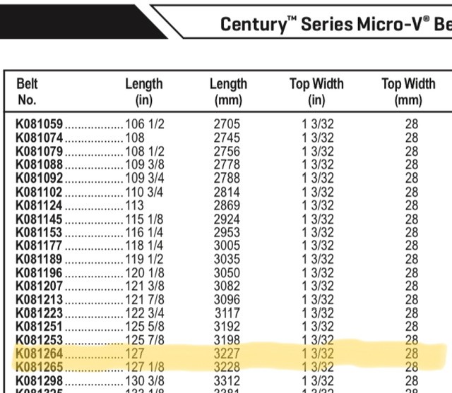

Go to Advance Auto and pick up a listed Dayco belt for my 2012 3500.
NO way it'll fit! At least a 1/2" short. Call Dayco customer service and finally get to a "Sales Engineer". Opps our catalogue is wrong, the belt listed is 1/2" too short. Fine, he gave me the correct belt number and nobody had it. The parts gal looked up a belt that would be a 1/2" longer... and in fact it WAS a 1/2" longer than the Factory Belt. Went to Napa, Gates belt. It too is 1/2" shorter than the factory belt.
Morar part number 53041138AE and no one seems to make an identical belt (that I can get). The dealer wants $150 for the belt. A $75 premium for instant gratification. Not paying that!

Dayco # 5081260 which the tech said should have been a 5081265 (unavailable locally)
The other belt that was too long I don't have the number.
This morning's Gates 25-081264 would not go on, that was this morning's first try.Then a Gates 25-081256 on the second try, fit's perfect.
Since Gates doesn’t have a K081256 and that it would be shorter than the K081264, I’m assuming you ended up using a K081265. It is 1/8” longer than the K081264 that the catalog calls for.
Exactly! That 1/8" is all it took to get the belt over the lip of the pulley.
My hands and arms look like ground beef, but it's in and working as it should.
There is something wrong with this chart as in metric they state only 1mm longer - which is 1/25.4" and not 1/8".
