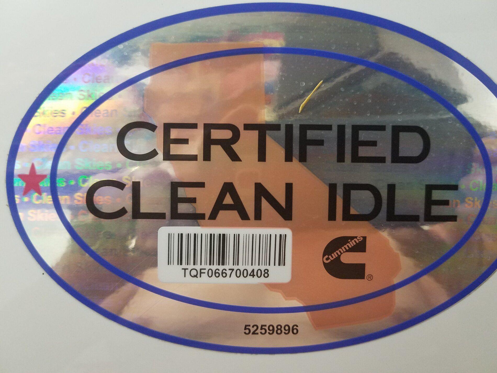

Ron, Is that a California Clean air sticker on the fender?
Video played on Windoze10 and Firefox. Nice service touch!
No, it's a clean idle sticker that comes on all of the 4500 and 5500 C&Cs. I guess it allows idling to run PTO equipment and extended idling. Not sure, to be honest.
EDIT: Upon closer look, it could be a CARB certified clean idle sticker.
