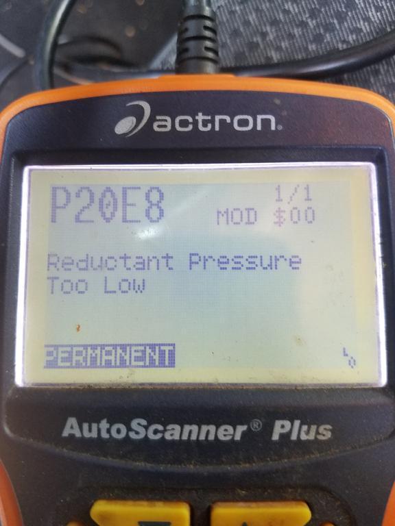

And so here is my most recent finding.
What would be the next reasonable step? While I have had a few different codes come up since I bought this truck used just a couple thousand miles ago, this is the most recent. All of the previous codes are related to the DEF system as well.
Possible Causes
DIESEL EXHAUST FLUID PUMP RECENTLY INSTALLED, BUT NOT FULLY PRIMED
LOW DIESEL EXHAUST FLUID LEVEL
CONTAMINATED DIESEL EXHAUST FLUID
DEF PRESSURE LINE DAMAGED/LEAKING
DEF INJECTOR PHYSICALLY STUCK OPEN
DEF INJECTOR RESTRICTION
DEF SUPPLY TUBE RESTRICTION
DEF SUPPLY PUMP ASSEMBLY
I have found cases where a bad frame ground has caused this and some with corrosion in the harness connector.With out the ability to perform the scan tool prime test it's going to be tough without spending some big coin.The def pump is not cheap
