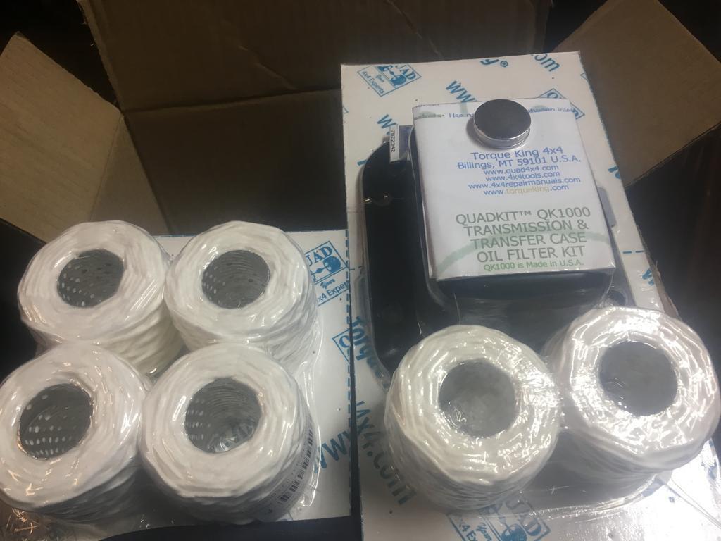

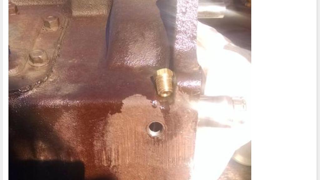

Got my shipment from quad 4x4 now to get her on the hoist and change trans oil t case oil rear diff oil and add a drain plug to the trans and contemplating adding one to the rear diff
1992 was the last year for a factory drain plug on the nv4500 the pto bolt trick is a pia if you want to get all the oil out anyway
I run a filter as well debating on adding the trans cool cooler from genos they sell em singley now so I could run a filter on one side and a cooler on the other are you running a cooler ?

No 92 was the last year for a factory drain plug which was before dodge used the nv4500 . I said I added a drain plug and I'm going to add one on my 94 as well why this thread is even the 24 valve section I don't know
