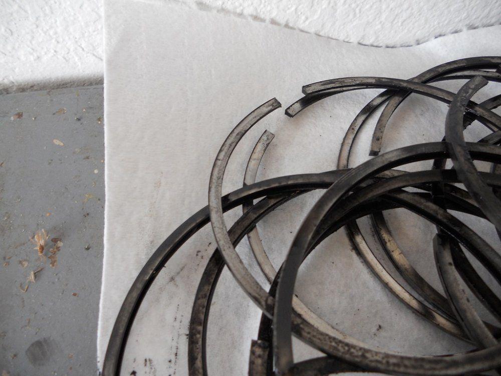

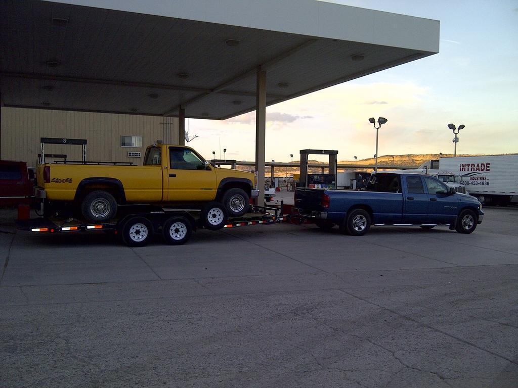

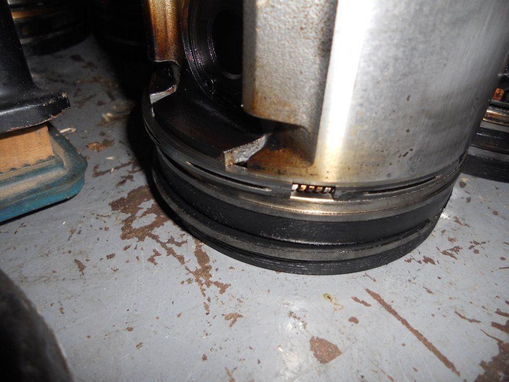

I am currently rebuilding a 6.5 diesel (that yellow truck I have a pic of towing) that was run on a contaminated with gasoline diesel and retarded timing. (Fuel in it smelled like gasoline.) It washed the rings clean out of the engine. Seriously the rings are a grey sludge in the oil pan. I bought it cheap because it wouldn't start anymore. The blow by when I did get it to start was impressive. It even had blowby just spinning on the starter...
No rails left on 4 of 8 oil control rings:
The black on the top 2 upper left rings is not just carbon - the rings are worn on the sides leaving a razor sharp ridge on both sides of the outside ring.
