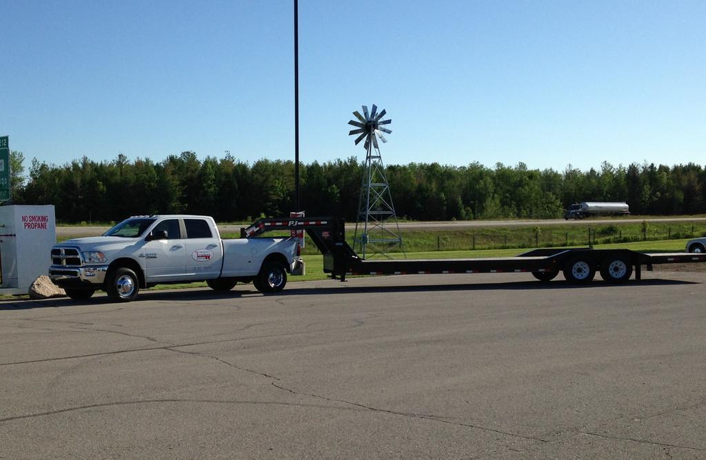

Installed a B&W gooseneck hitch and wiring. So I could make a run to TX, the rest of the goodies will have to wait
I towed an empty 6,400 lb 32’ PJ low profile gooseneck with 8k axles, 110psi G ratted tries. The truck got 13.9 mpg on the way down. It had 400 miles on it when I left. I thought that mpg was ok.
With no trailer the air ride rode just a little bit better, the bumps were just a little less sharp. After hooking up a trailer I was able to play with the air leveling button. The ride with a trailer is really impressive. It is much better than I expected. I run my tires at 65psi. I was concerned about axle wrap. When you lower the truck to the level setting it loads the springs. The kicker springs should be tighter on the level setting helping to control axle wrap. Makes me wonder what it looks like under heavy braking and it twists the other way.
The trans works really well as does the exhaust brake. The only thing I noticed, is when you slow down, almost stop, and roll through a stop sometimes it hunts for a gear between first and second. It almost felt like a quick shutter but it’s not. It’s just making up its mind. This was more noticeable on the way back. The trailer and load was about 15,500 lbs. The load was low and the truck dealt with it like it wasn’t there. It never downshifted more than one gear in the Ozarks. It did go back and forth too often at times it seemed but I haven’t driven it enough yet.
