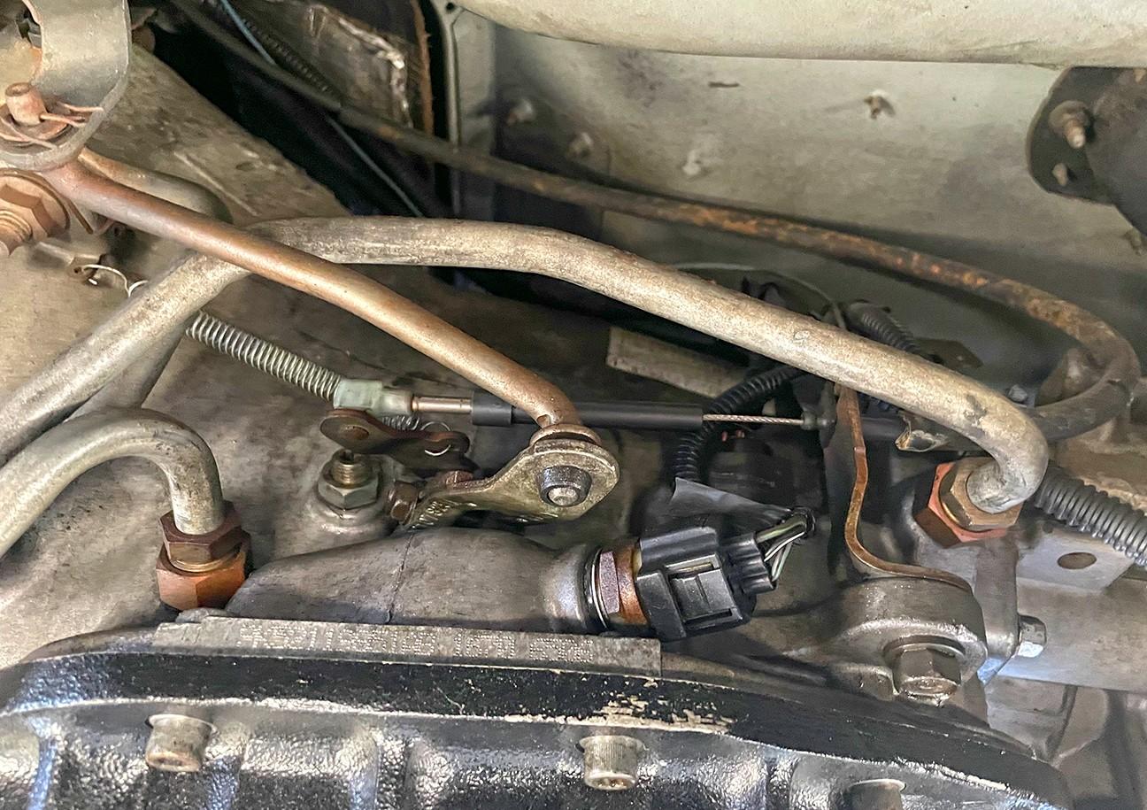

I have a DTT trans in a 2001 and I've always hit neutral between D and R and vice versa. Had a transmission shop service my trans and now it's very slow to disengage from Drive to Nuetral...it's been quickly shifting out of Drive and into Neutral for 15+ years and the RPM's would immediately increase when shifted into N. But now, when I shift from D to N it's very very slow to disengage from D and seems to be hung in D for a few seconds, if not more.
What would cause the trans to disengage from Drive slowly when shifted into Neutral? Is there something with the the way they reassembled the linkage? An simple adjustments for this? i noticed this spring looks new and appears to be pretty wimpy...does this spring have anything to do with it?
