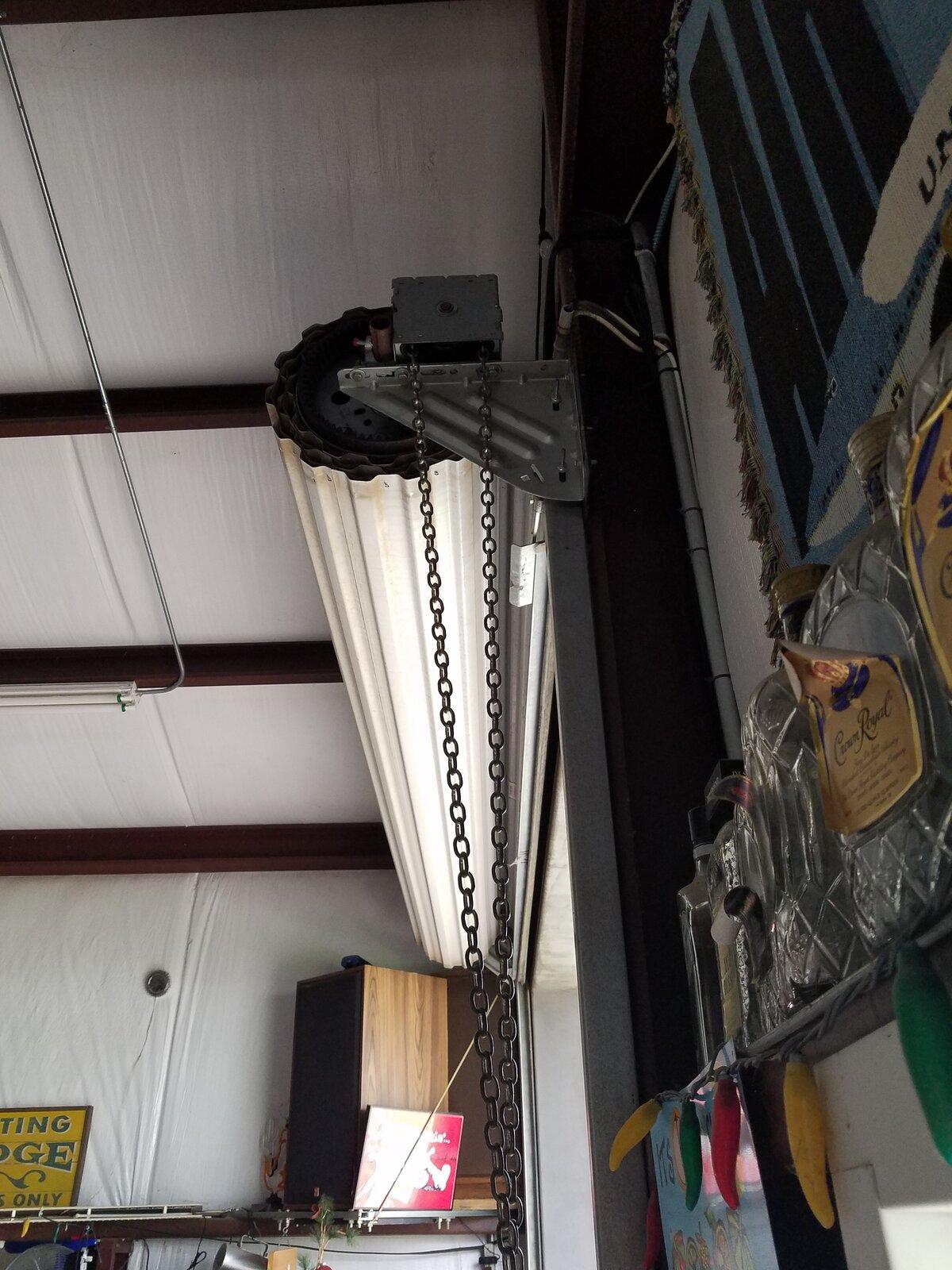

Sorry, no real good pics of door, but if you look in the upper left. you can see how well the door rail hugs the ceiling.
Hope thi helps. I'm out and about right now, but happy to post more pics of both if interested.
Cheers, Ron

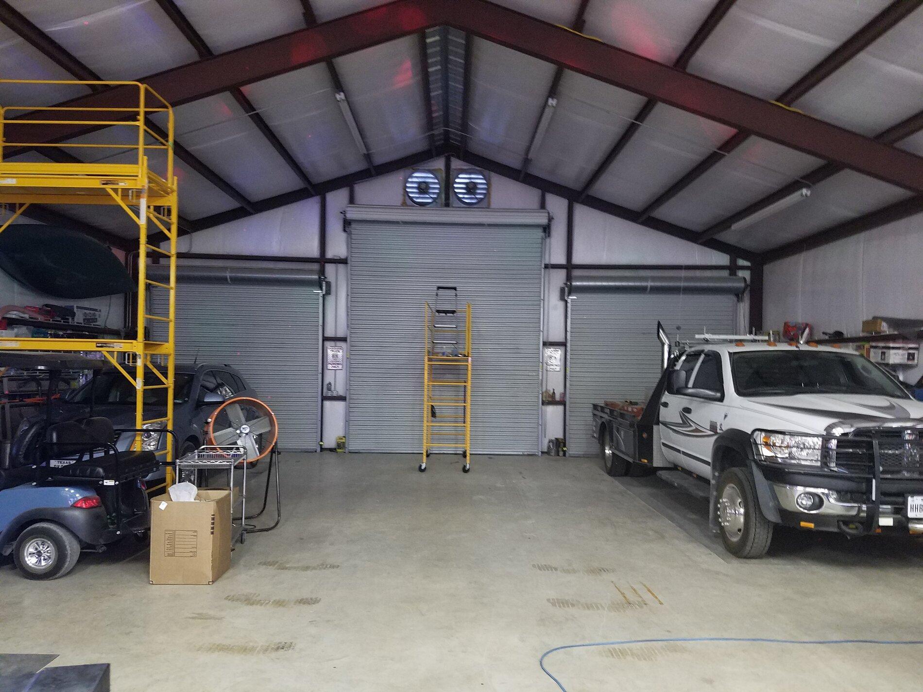

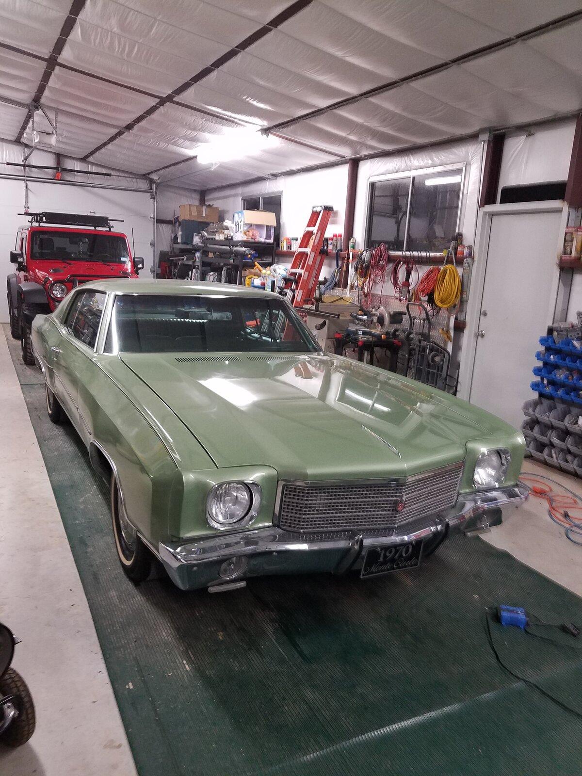

I took a couple pics that shows both door types
Looks like standard roll up needs about 8 inches above the top of the door. 9ft by 9ft
And my 10ft x 10ft needs 18" to 24" above opening:
