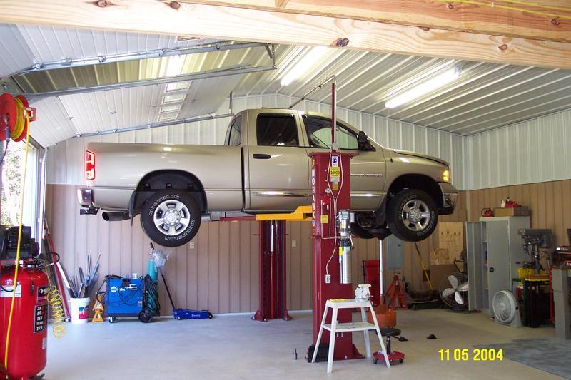

FWIW--- I also have 14' feet height at the center of my shop. My shop is 48' wide X 30' deep but I have the workbenches in front of the truck so I located my symmetrical Mohawk 10k lift about 1 foot closer to the garage roll up door for extra workroom up front. The wall height at the front and back is 12 feet.
No problem with the center height and I clear the roll up doors with the bed OK, (would be a problem with a bed cap or topper). With the unit at max height the cab clears the overhead hydraulic crossover lines by less than 1 foot. Remember even if you have a lift on the truck the lift picks it up by the frame and if I can remember the lift travel is only about 72", (6 feet). In the picture I have the truck about 6 inches short of max height because the oil change catch pan won't extend any further and it will splash out when you drop the oil plug out. I'm just shy of 6 feet so I my head can touch the lift arms if I'm not careful but I always run into the tires . I get too focused on the work at hand I guess. You'll train yourself to stoop a little all the time.
As far as the asymmetrical vs symmetrical, I really don't know how to advise you. I choose the symmetrical type and purchased the commercial Mohawk because I witnessed a mechanic trying to replace an exhaust system on a diesel 4X4 and was horrified as he tugged back and forth on the exhaust system and the whole truck was swaying back and forth. The stamped type posts were flexing and allowing too much lateral movement in my opinion. That lift was an asymmetrical type, (capacity and brand I'm not sure of). Of course common sense applies when using a lift so maybe this was an anomaly.
The distance between the posts is 10 feet, plenty of clearance but I have friends that have the asymmetrical type and they are definitely handy when entering and exiting the vehicle. Also have friends with the drive on ramp type and they are convenient for quick oil changes and such.
