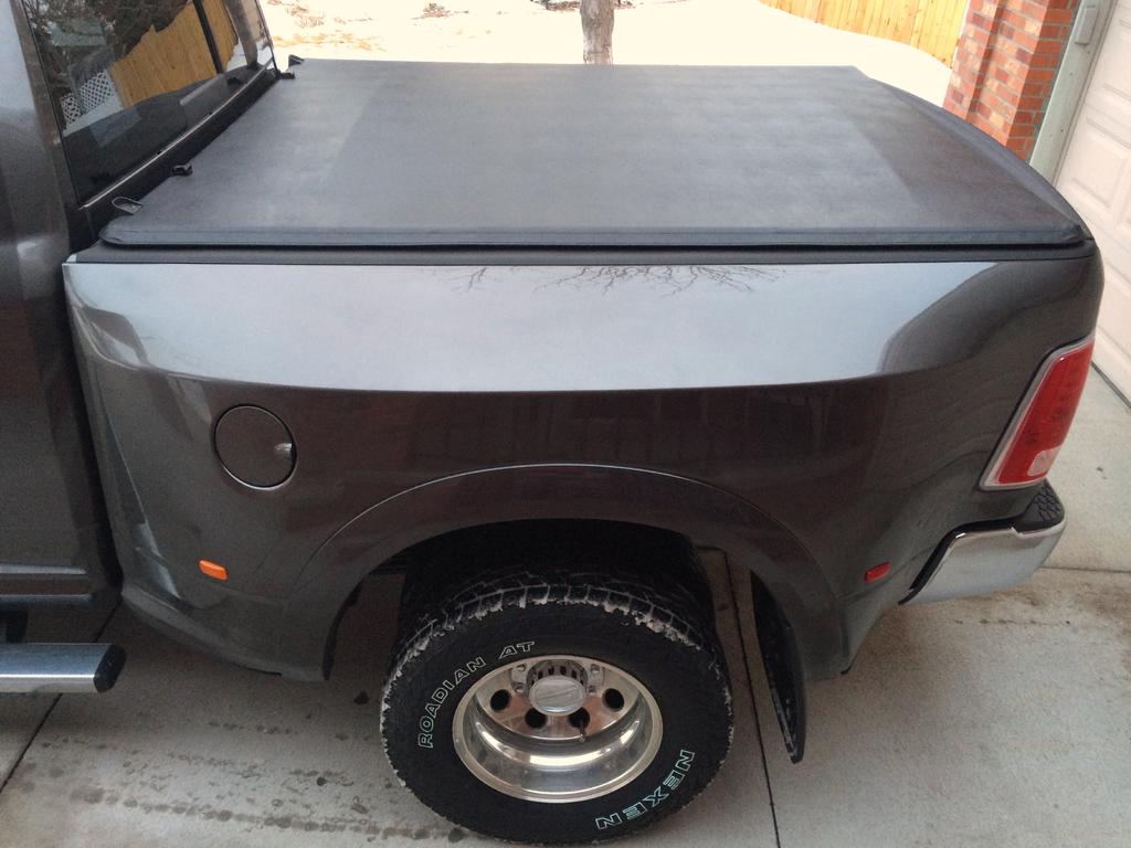

I had a tank custom built to my size spec.s and fitting spec.s by TidyTanks up here in Canada so that it would fit under my quad deck and in between the rails. It cost about the same as the standard ones off the shelf for the most part. You could get one built that fits to the size you need.
I agree w/ MPaulson. Might have to get a custom tank made to maximize your space.
