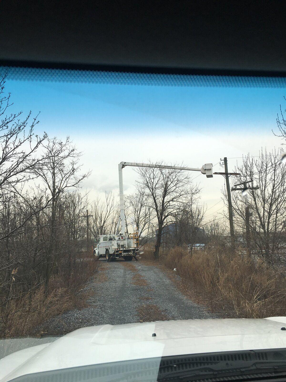

I’m sure the intent is for a vocational truck like a bucket truck on a big job. It’ll start/stop and idle all day until the job is done. And if that truck is stuck in a big city where it can’t stretch it’s legs, that button is gold.
In the picture below, the Sterling bucket truck got into exactly that scenario. It sooted up, shut down, and the electricians killed the back up batteries because they thought they could finish the job and get down.
NOPE! It was me who had to juice up everything and do a stationary regen.
That button would have prevented those guys from having to jump out of that bucket and into another one.
Oh yea it was COLD OUT!
